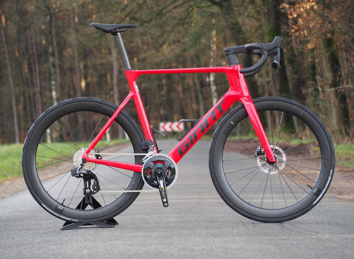

I have a 2020 propel advanced disk 1. My shifter broke and I couldn’t find a replacement shimano shifter but I could find a sram axs groupset. What i needed: a new groupset, a new crankset, a new bottom bracket, a new chain, and a new cassette and frame plugs (total cost around 2000 euro including work done by the bike shop)
It was a fantastic upgrade. After upgrading i realised that the propel frame never was meant for mechanical shifting: too many tight bends and thr cable tension necessary to run the cables through the handlebar and stem meant steering and shifting never could be good but with SRAM AXS it is

I’m also thinking about waiting until November when they release the new ones BUT I do love this red colour!! Do you guys think though that it should come with SRAMS next level group set though? Isn’t Rival entry level really?

Yeah I really like the idea of that, I’m always tucked over in the aero position with my hands on the hoods and its just one less thing to do. I’m so tempted to get this new propel. £500 more though gets me the 0 and not the 1, the 0 has Di2… I wonder if there’s any difference in frame stiffness with the 2023 Pro models 0 and 1. I can’t seem to find any information online saying otherwise
EDIT: And I love their chain!! That straight line is very nice ha

I really like the look of the red frameset, wish they had that color option in the US. Rival is entry level in terms of electronic shifting, but the the thing about electronic shifting is that all of the levels are so good that it really only boils down to weight. In fact a few reviewers (James Huang as well as one whose names escapes me right now) have commented that Rival actually feels a little faster than Red and Force. A lot of people seem to like the Rival shifter shape better as well - SRAM updated the Force levers to have the shape/feel more like Rival (and rumor is the new Red will be moving that way as well).
In terms of weight, the biggest gaps are in the cassette and crankset. Those pieces might be worth paying more for or upgrading later down the line. On the 1x bike I built up I went Rival shifters/brakes and RD. Force cassette, chain (since it was basically the same price) and cranks. I previously had Ultegra 11s 2x Di2. Both groups have performed similarly for me which is to say they are both excellent
