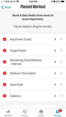

What data do you have on your workout screen when doing outside TR workouts?
I did Carson outside on Thursday with these:
Target Watts
3 Sec Avg Watts
Remaining lap time
BPM
RPM
Hitting target was a challenge as I would watch the average watts and would overshoot the target and then adjust and undershoot the target. rinse and repeat for the intervals. flatter terrain was easier to tighten it up but still challenging.
I think I will change out 3 sec average for 10 second average and add Lap Avg Watts
What fields do you use?
I use factory default but zoom in until only Target Watts & 3 Sec Avg Watts remain.

Wahoo didn’t have 10 second power so I used 20 second power. Didn’t use NP.
Did Tunnabora outside last night and did alot better than the previous weeks attempt at Carson. Part of that is that I picked a better route(really the only option around here that is consistent enough for anything over 1 minute long.) But having Interval(Lap) Average and 20 second power worked wonders to keep me from trying to micromanage my power to the target.

I mirrored the TR app, these were the fields. I haven’t found that an overall Average Power or NP is necessary.
