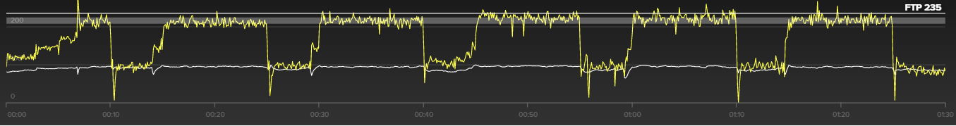

I have been trying to do all my workouts outside recently. In my experience, I don’t “nail” the zones the same way I would inside, but I feel like I am getting 90% of the intended benefit, plus it’s way more fun. Also, as others have mentioned, being able to hold somewhat steady power over varying terrain is a skill that could come in handy in a race.
Here are two similar workouts (5x10 sweet spot), one outside and one inside. They look pretty similar to me.
Outside
Time in Zones:
  • Tempo: 12:13
  • Sweet Spot: 16:26
  • Threshold: 20:04
Inside
Time in Zones:
  • Tempo: 13:18
  • Sweet Spot: 21:57
  • Threshold: 15:31
It looks like I am spending more time in Sweet Spot and less time in Threshold inside, but it’s pretty close. That being said, when I go into Threshold, I’m pretty sure I’m on the low end, which is still pretty close to Sweet Spot, so I doubt the training effect / physiological impact is that different.
My only concern is that after a few weeks of accumulating more time in Threshold than intended, I may wear myself out and have a negative impact on subsequent workouts. We shall see!
