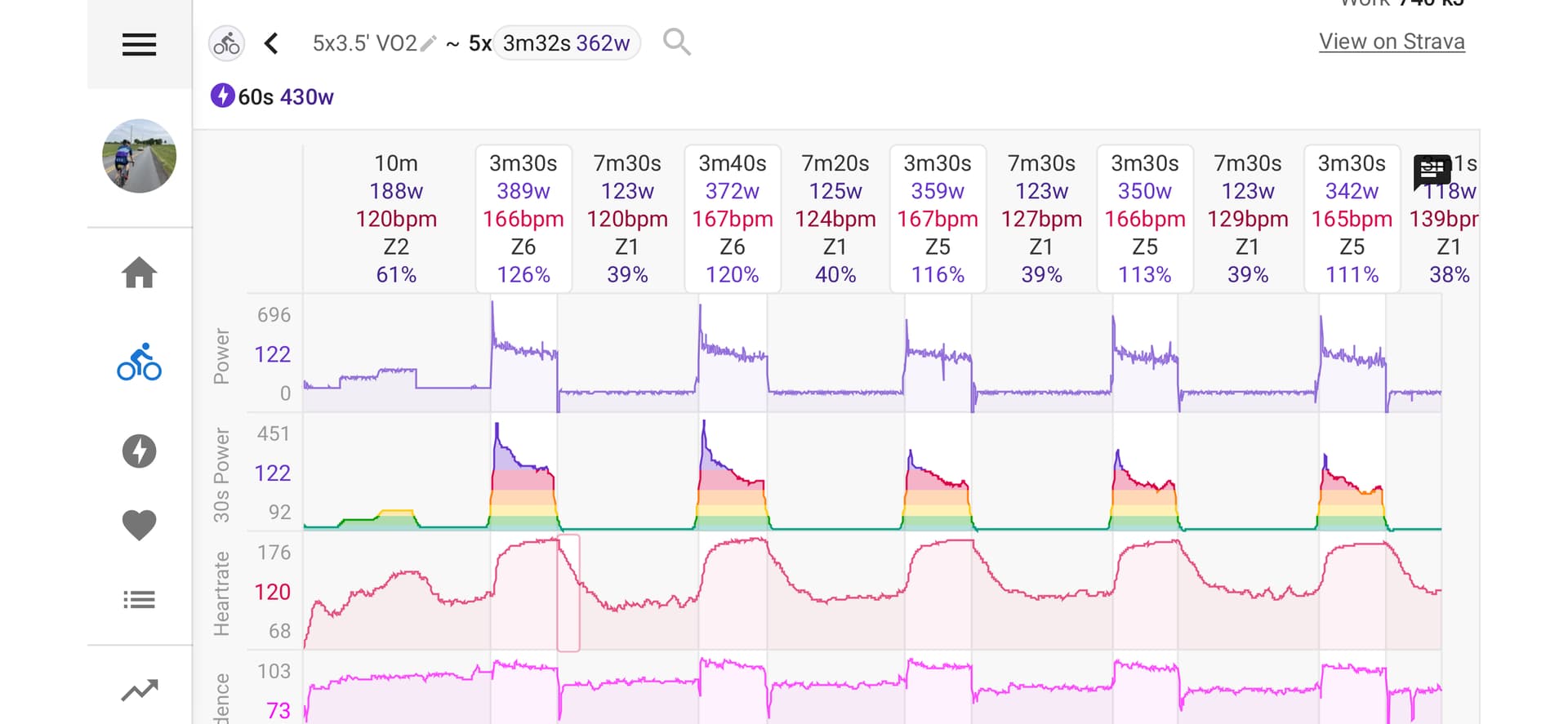

I just did a 5x3.5’ v02 hat I made custom
You can see I do hard starts and just go as hard as I can. There is some heart rate lag but my max gets to 95% which is about as good as I can do on the trainer (also on third week of this v02 block so I’m tired as hell).

Exactly - look at the workout I posted form this morning. By the 5th set I couldn’t hold the “target” (which was fake when I made the custom workout) and ended up averaging 111% rather than 120/118% (I can’t remember which one I made the target) and in erg mode I would have had to quit that interval - but my HR was in the right place for the workout. I expect this fatigue by the last set.
