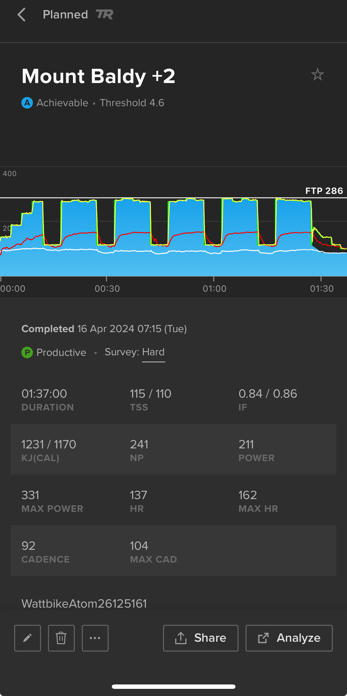

Trusting AT, I actually took on Mount Baldy +2 which is 5x10 minute intervals, so one more than Mount Baldy BUT, this has 5 minute recovery valleys as opposed to the 3 minutes on last week’s workout. I think this made a difference because during the last 2 minutes of each recovery valley my HR went way down and I felt much fresher going into each interval.
I feel awesome having completed it, so maybe going forward I should consider reducing recovery valleys over time.

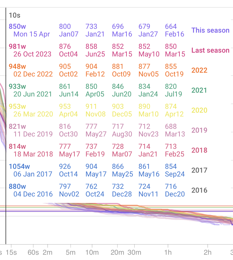

For example last night I went out and did ‘time to work on 10-sec sprints’ every 5 minutes during a 90 minute endurance ride. Really just working on form. Here is what it looks like in Intervals for the last couple years (in WKO I have charts):
pretty obvious I haven’t been working really short durations this year, and last night was just the start and I landed at #5 effort from just over a year ago. Last night I was just working on form and not pushing power yet.

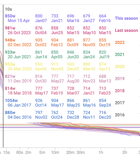

In WKO I have a chart showing 10-sec (and other) power:
you can do something similar in Intervals too.
Now that I’ve worked on form, next time out all of the 10-sec power peaks should be over 800 and I’ll give them a little more gas.
