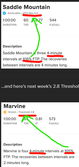

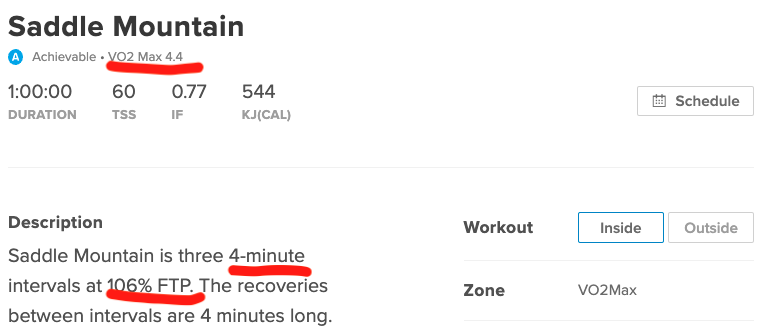

I *Thought* I Knew The Difference Between VO2max And Threshold
Here’s the 4.4 VO2max workout I just finished…

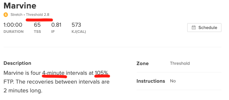

…and here’s next week’s 2.8 Threshold.
I’m guessing things are just weird at these “baby” progression levels?
Brave new world!
Yeah, this could be an error, but we have seen plenty of similar questions come back with “that’s what we intended”. The Level labeling is pointed to where the given workout is intended to “live” in the TR Workout Level spectrum, more than a direct “this is what it is” concept.
Workout Levels express the relative challenge of workouts within each training zone. They aren’t meant to compare workouts between two zones.
I guess my larger question is not so much “Why is the 2.8 harder than the 4.4?”, but rather, “If 106% of FTP is Threshold, how is 105% of FTP VO2max?”

If I am reading the pics you shared right, I think you have that backwards…
  • (green added by me to “connect the dots”)
Think of it this way- all efforts exist on a continuum. Some workouts near the border of one zone and another could technically be considered part of either, but we intentionally classify them as one or the other to serve within a specific training progression.

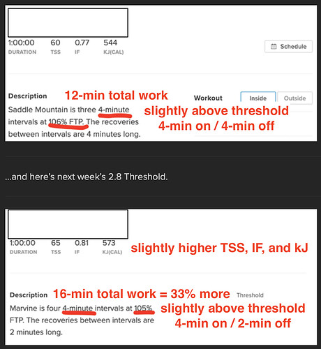

here is another way to think of it… ignore the workout levels (and impact on PLs) and focus on the work:
  • this week: 3 sets of 4-min on at 106% and 4-min off
  • next week: 4 sets of 4-min on at 105% and 2-min off
At 250W the “on” (work interval) power this week is 263W and next week is 265W. That is less than 1% increase, less than the accuracy of your power meter!!! The difference is so small you might as well ignore the power difference.
Ok since power is essentially the same let’s look at time:
  • this week: 12-min total work consisting of 4-min intervals with 4-min rest between
  • next week 16-min total work consisting of 4-min intervals with 2-min rest between
See the progression now?
Power is essentially the same, but total work jumped from 12-min of work to 16-min of work. That’s an increase of 33% week-to-week. And they are harder next week because the rest intervals decreased from 4 to 2 minutes, while keeping the work interval at 4-min. :muscle:
Have opinions on that but not going to discuss/debate that, just wanted to address the question posed at the end of the first post.
There is a clear progression, despite this week’s being labeled vo2max and next week’s labeled threshold. Point being, looking at labels and workout levels can be misleading particularly in the case of zone edges. Look past that to the underlying work.
