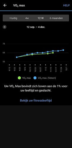

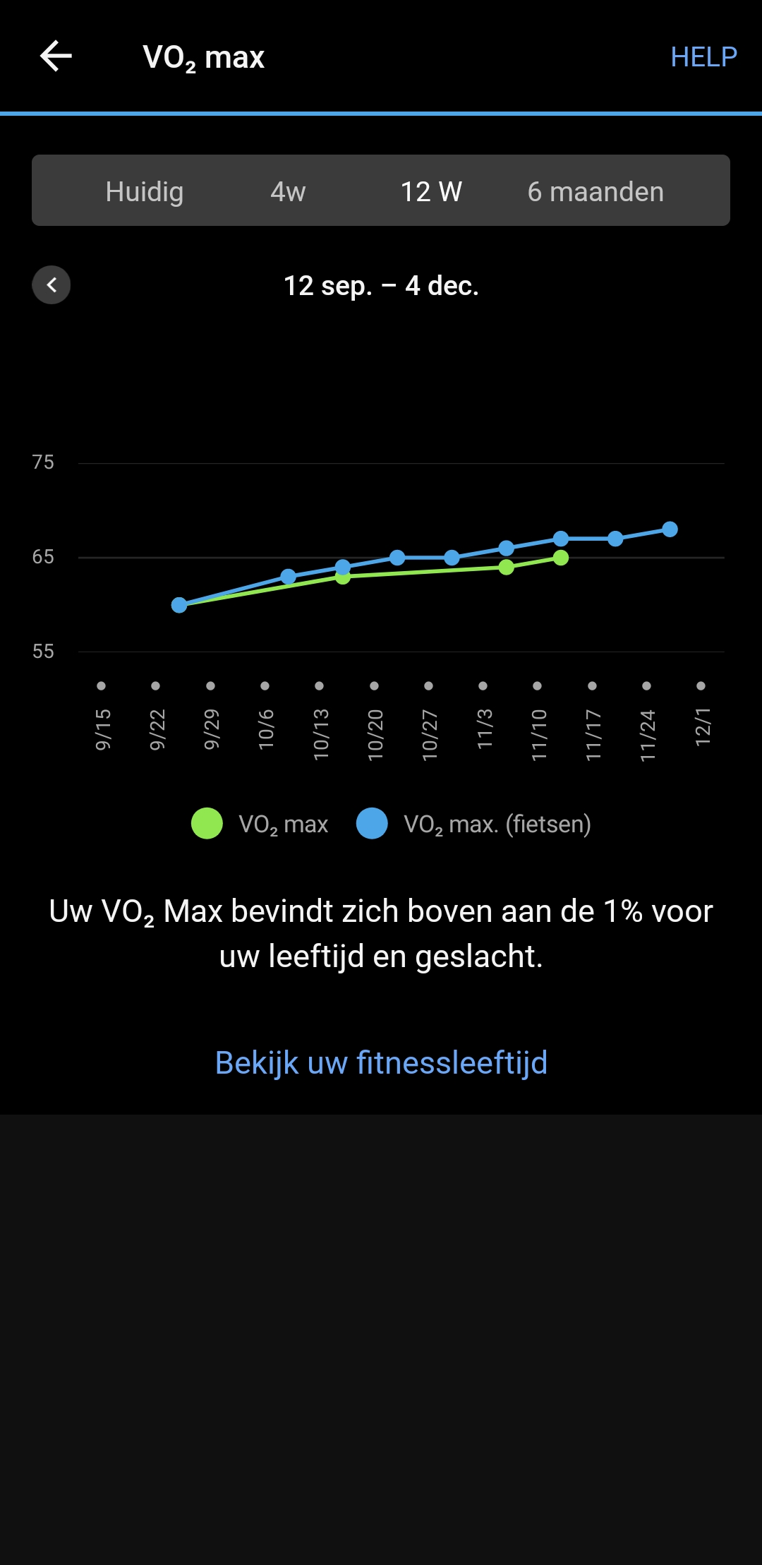

“indoor season” seems to be doing good things for my vo2max, more endurance is not good for the formula…
(from <60 to 68, not sure where the green/running vo2 max is coming from… I never recorded a run ever with the garmin…)
Increase at the same weight?
I.e due to decreased weight or improved fitness
no change in weight.
(fitness seems to be the same to, but maybe a shift from endurance to intensity)
