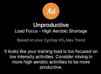

Something to watch out for Garmin VO2 Max….mine kept climbing recently, which as much as I would like it to be true seemed exceptionally high without a lot of explanation. Then I noticed how Garmin kept saying I needed more “high aerobic” work, right after I did a killer VO2 max session….weird.
So turns out that I had toggled on the auto max heart rate detection on my 530, and at some point it got an anomalous 220 max reading and changed it in my profile. My actual max is 183. So it decided when I was at 175 bpm in a VO2 max interval, that I still had 45 bpm to go and set my VO2 max well into the 70’s.
Moral of the story, I’d suggest toggling off the max heart rate auto detect in Garmin.
