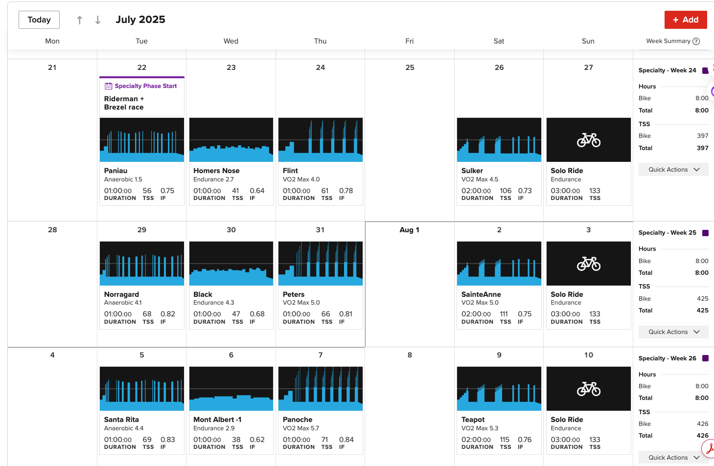

Something interesting happened in my adapted training schedule. It’s kind of setting up a VO2 Max block of seven weeks straight (with one recovery week in between):

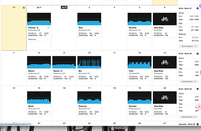

Before that block starts, it’s giving me three weeks of rest, which is interesting:
I haven’t seen anything like this on TR in over a year and a half of using it, and it reminded me of the discussions you guys are having here, so I thought it might be interesting to share.
In the custom plan builder, the “Getting Faster for Group Rides” also has this structure (1x Anaerobic and two times Vo2 Max) for the speciality phase. The “Improving Climbing” plan replaces the Anaerobic with Threshold, but also has two times Vo2 Max in the speciality phase.
