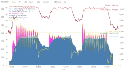

Sorry for slightly hijacking this thread for my own interests… but the great discussion here inspired me to dig a bit more into the literature and synthesize some ideas about how metabolic intensity and mechanical workload might relate to VO2max trainability. Hopefully relevant to the conversation!
Quickest 3000 words I’ve written in a while :sweat_smile:

One of my colleagues was supposed to investigate something like this over the summer, with a mix of HIIT (4+ min ‘classic’ VO2max) and SIT (sprint interval training; ie. 20-30sec all-out, ~5min recoveries). As a follow up to his meta-analysis.
But then COVID…
I’m currently writing a proposal for a fake-study design (in a fantasy land where I had all the time, resources, and willing subjects :sweat_smile:) to compare hard-start to evenly-paced training.
I do think - and this is totally speculative/opinion - that mixing interval types within microcycles should be able to optimize training load across different limiters; central vs peripheral, etc. At the end of the article I give an example of performing a 30/15s (or SIT) workout to smash the legs on Monday, then say on Wednesday before the legs are fully recovered, add a hard-start long HIIT workout to give the cardiovascular system a bonus stimulus, while the legs can still handle the lower workload.
