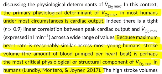

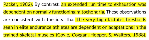

To your point I think there is more nuance currently being investigated, but I think the prevailing view is cardiac output generally limits VO2max. [edit] However VO2max doesn’t necessarily limit performance.
From a very recent review by Dr. Michael Joyner
but also
