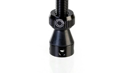

Did you use the special valves that stop the air-liners blocking the hole? ![]()

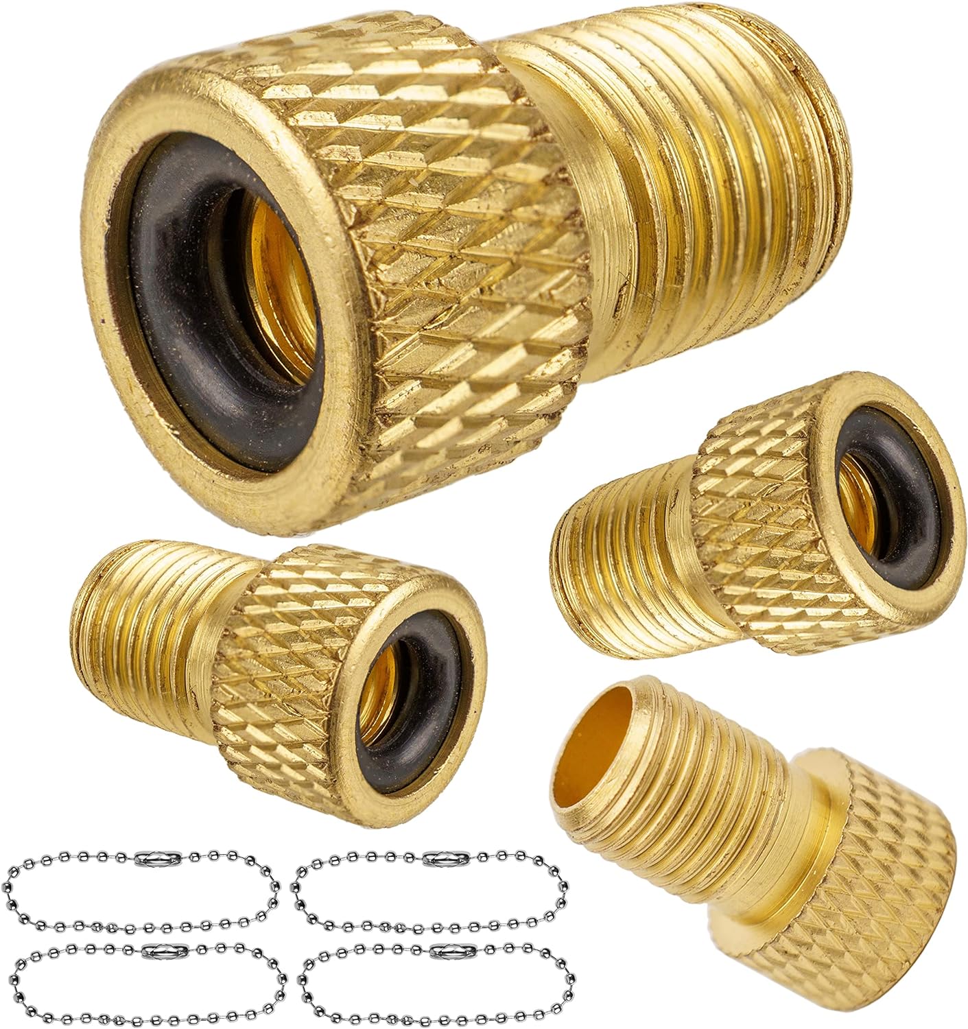

That’s about the only injector which also needs an adaptor (not included with the injector) which works for me. Occasionally I use a thin Allen key to poke through the valve
I was thinking these valves with the side holes
But even with these valves I ended up in a similar position to you - still really hard to remove the tyre on the road without the tyre removal claw thingy.

Thats the same thing I have except for the adapter
But the silicon hose is pretty tight at the valve but the adapter looks great. Where did you got it from? Sadly poking the valve doesnt get you anywere with the vittoria valves for the airliner because its basically a dead and and got several holes at the side (if I remember correct)
That adaptor I use for injecting sealant came from my old broken effeto mariposa syringe but my small bosch hand compressor came with the exact same adaptor
edit: it was easy to find on amazon

Also handy to carry in case you need to use a filling station/ car compressor in an emergency (hand pump failure!).
