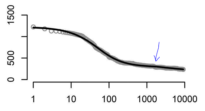

I’ve never understood why the WKO model shows a smooth downward deflection. versus the abrupt transition you see with models like this. Any idea?
My understanding is the inflection point is where you go past MLSS (maximal lactate steady state). Below MLSS, your body can clear lactate, above it accumulates.
Hmm I don’t think the WKO PD curve model is smooth?! (look at stevemz’s graphic above).
It seems to be pretty similar to the formula I posted. Above TTE the decrease in power is essentially linear in log t.
This is the region I meant. The transition looks pretty smooth to me.
No, I don’t think so. The above formula should yield about this. (Of course it’s continuous - there is no “jump”, but it’s not smoother than that.)
Here’s the graph corresponding to the PD model of the formula I posted above. It’s not an abrupt transition but you can guess the “inflection point” (I really don’t like this name XD).
WKO model (red) with 90-days / 82 rides of actual data (yellow), I put the cursor at the time duration of my modeled FTP:

Thanks for the screenshot - that’s a nice example where there is no inflection point around FTP in the actual data. It only shows up in the modeled line in red.
Obviously you can’t tell for sure by visual inspection, but to me the aerobic part of the WKO PD curve (green dashed line) looks very much like something log-linear past FTP.

Right, that’s what I’m getting at. Other attempts show a distinct transition point, whereas the WKO modeled P-D curve is smooth, or at least smoother - why?
ETA. Here’s another example. Note how smooth the red curve is compared to the sharp kink in the modified P & T model.
As I understand it (from a Tim Cusick post), there are a family of PD curves. The algorithm maps your 90-day MMP to one of those curves.
Now I’m really confused - I thought that was how ICU did things?
I don’t think that the WKO model is very different from other models (I don’t have the expertise to judge this myself but the creators of those other models claim this), see the link already mentioned above Peronnet and Thibault; the source model under the hood of WKO4 WKO5 - veloclinic
If WKO really is this model then the “sharpness of the inflection” just depends on the parameters you choose to use (i.e. the data).
What models do you have in mind with a sharper “turn” at FTP? (Edit: Just saw your addition.)
