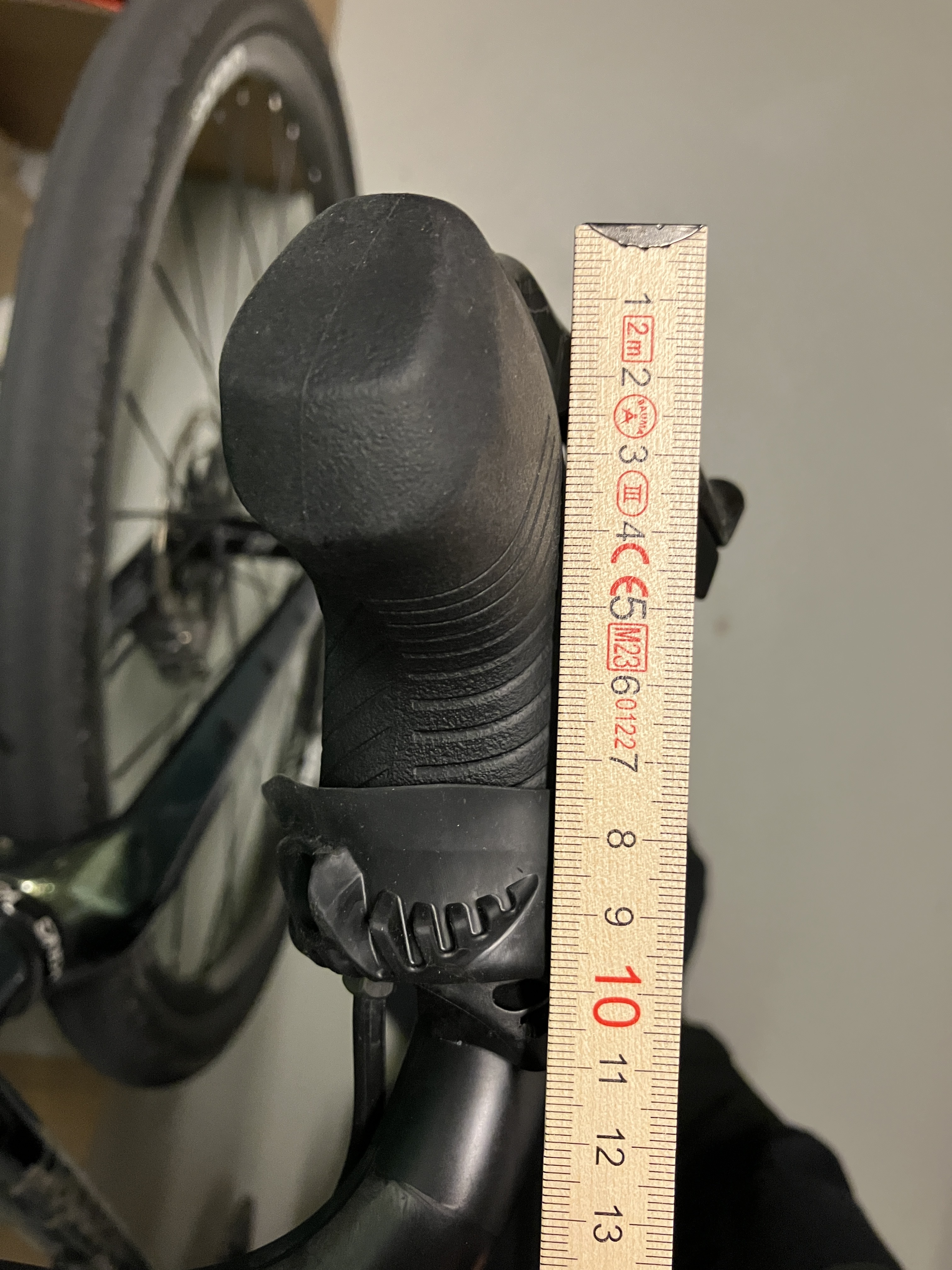

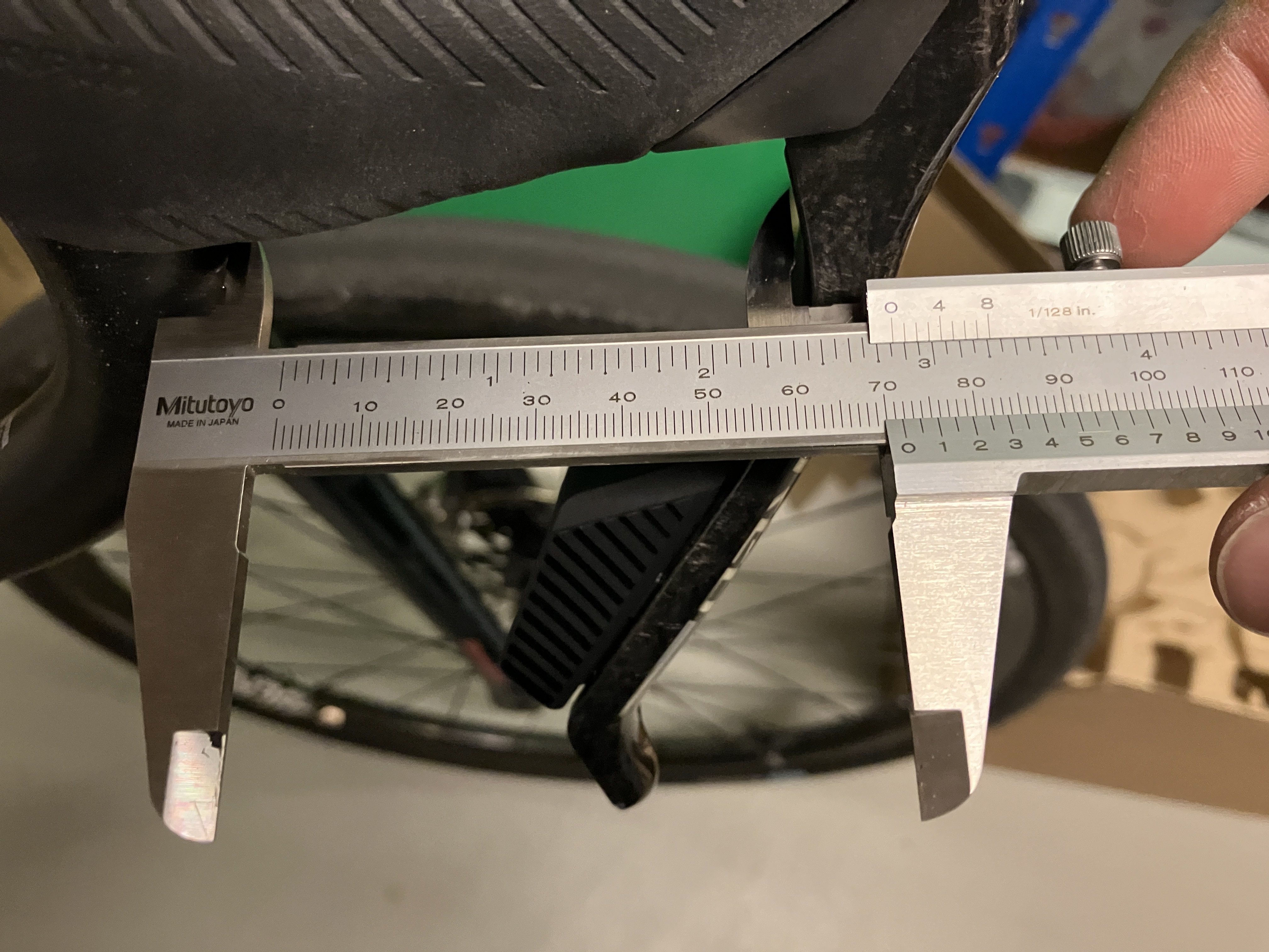

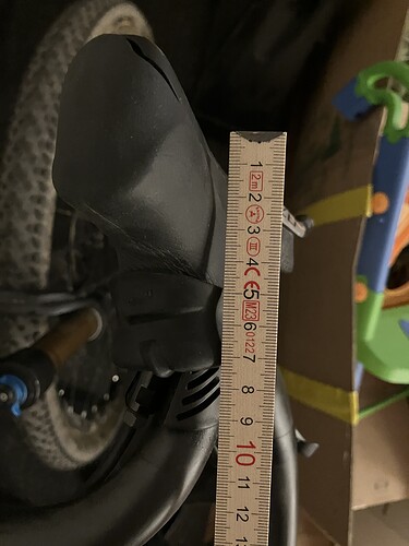

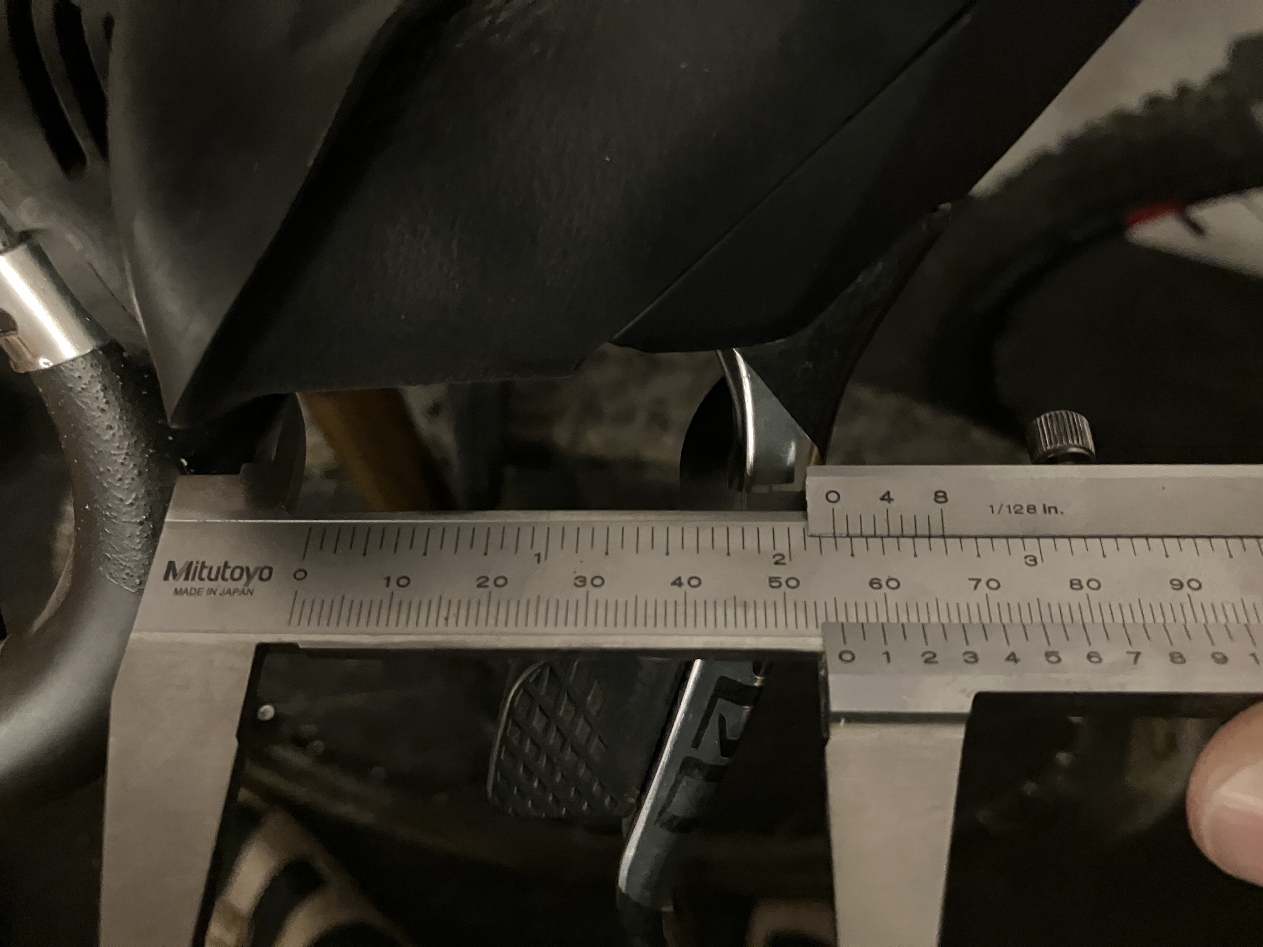

I have both shifters mounted to different bikes. I’ll snap some pics once I’m home. The E1 is certainly longer than the D1. I have large hands and can now fit all fingers between lever and bar wheras with the D1 it was only middle and ring finger.
Did you have to change the stem or body position as a result?
@OreoCookie yes, went from 110 to 100mm
Edit:
It‘s kind of difficult to photograph it properly and I might retract my statement regarding reach… they might be not that far off. The lever design of the E1 allows for more room but seems to be similar in length position-wise.
Found the vid I mentioned earlier that does seem to reinforce your findings too. About 2:30 in he talks about the reach of both versions.
