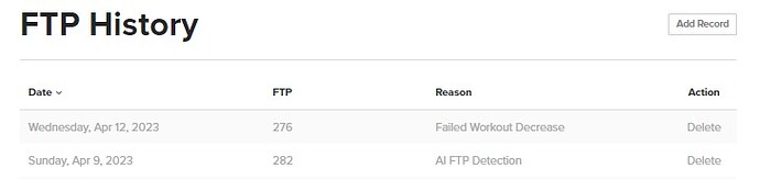

Same thing has happened to me. I successfully completed Truchas +1 last night, a 6.3 sweet spot workout, and marked it as very hard as still getting over a nasty cold and legs were a little cooked from an outdoor ride earlier in the day. Got the failure survey, marked the reason as training fatigue and I got the ‘Let’s get you back on track’ message with a suggestion to reduce my FTP by 6 watts. I accepted this and it increased my current PL’s a little and changed all my upcoming workouts for ones with higher PLs. The irony being that AIFTPD only ran on Monday and I got a 2 watt increase. Have tried changing last night’s workout survey to hard but it hasn’t changed anything other than I’ve now got a load of ghost workouts showing up on my previous history which weren’t there before.
Just to add, I bailed early on a scheduled 7.2 PL sweep spot workout on Monday due to the cold and marked the failure survey reason as sick. Perhaps this was a trigger?

Guess I can manually update my FTP back to where it was but will this trigger AT to put the upcoming workouts back to where they were?
Edit: Have contacted support about this.
