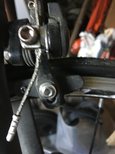

I have a Cube Attain GTC (~1600 euro) I bought about 4 years ago. I have had no problem with tyres until I’d say the past 6 months when I started buying Continental 5000 Grand Prix Tyres. Firstly, I thought someone had slashed one of my tyres as there was a long blowout in the side wall of the tyre just above wire. Unbelievably I only noticed it until I went back to the bike after work to cycle home and that’s why I thought it strange. Anyway, Covid came in and I had to fix. I bought another Continental 5000 (from Halfords again) and as I was blowing up tyre it exploded in exactly the same way. Nowhere near 100 PSI. I thought fair enough. That was probably my fault as I tried to put in an anti-puncture strip inside the tyre which has worked really well in the back tyre (back tyre is a Continental Ultra Sport). So I removed the anti-puncture strip and bought another Continental 5000 Grand Prix tyre. I got about 1 mile down the road and the tyre exploded again. Same Issue. I then went and got the last Continental 5000 Grand Prix from Halfords (I know - you think I’d have learned, but everyone tells me they are a great race tyre. Now I have just walked home after only getting 5 miles. There is no metal sticking out of the side wall. There was no sign of a genuine puncture - and I do this journey a lot for work.
I cannot understand it. If it was a puncture like I’ve had in the past why in the hell does the tyre always explode just above the side rim. I put pressure to 100 PSI.
Can anyone help - is this a bad batch or am I doing something wrong?

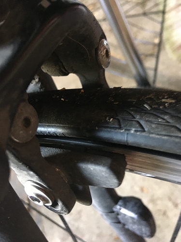

Is your brake pad rubbing on the tire?
My first thought too after seeing the second photo.

I have to say I looked at it and it is close, but I didn’t think close enough. I’ll have to adjust and test. That can be only explanation. Stupid old me - should have looked beforehand. And…as you say…I’ll blame it on Trump :wink:

Thought the same about the brake pad rubbing, but you should also hear or feel that. I’ve had that once, and it took a chunk out of the tyre really quickly.

So there was no rubbing noise when I was cycling or smell or rubber. The metal rim of the wheel was not bent or splintered in any way. No metal fragments, glass or any other intrusion. @PusherMan - yes it’s a plastic lever I use to seat tyre on the rim, but as you say that is another feasible reason as the tyres are incredibly tight. I use a hair dryer to slightly warm up before applying, but still very tight. If I was compromising the wall I would have thought the beads would have gone first. Maybe not.

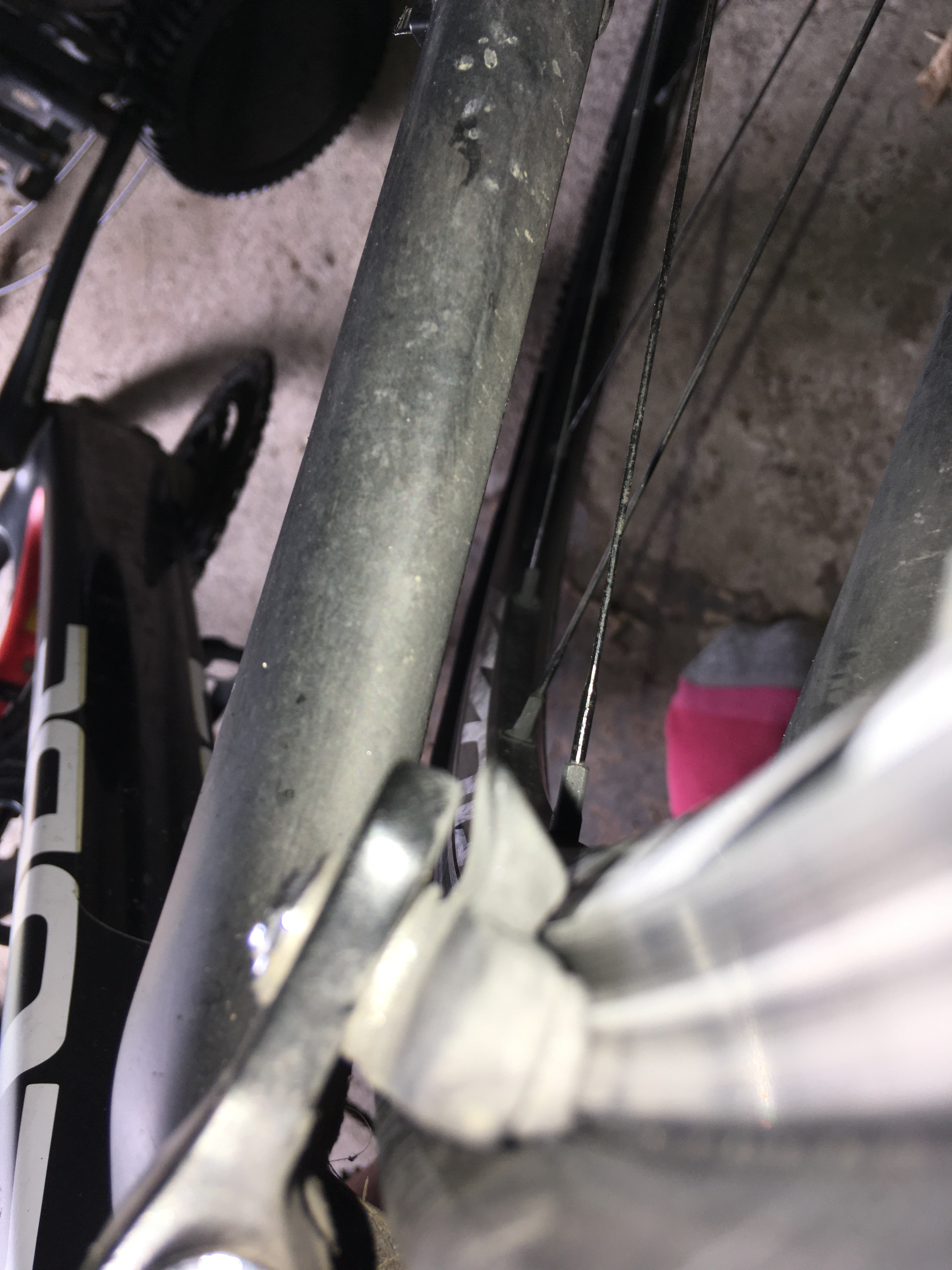

OK - so I just went outside as this whole saga has been winding me up. Poor lighting in shed so got torch to look closer - I’m getting on so the eyesight is crap :wink: . I squeezed the brakes and realised the break is just over the rim and hence the brake has a rubber lip over the rim onto the tyre. See pic.
So daft I missed that. Cost me 150 euro-ish. Now duly noted.
Thanks for your help.
Just to add for anyone that stumbles on this is to remember that tyre can widen a small bit when weight is on also. This means that if the clearance to brakes is very tight, the extra width that comes when you sit on saddle can cause rub.
