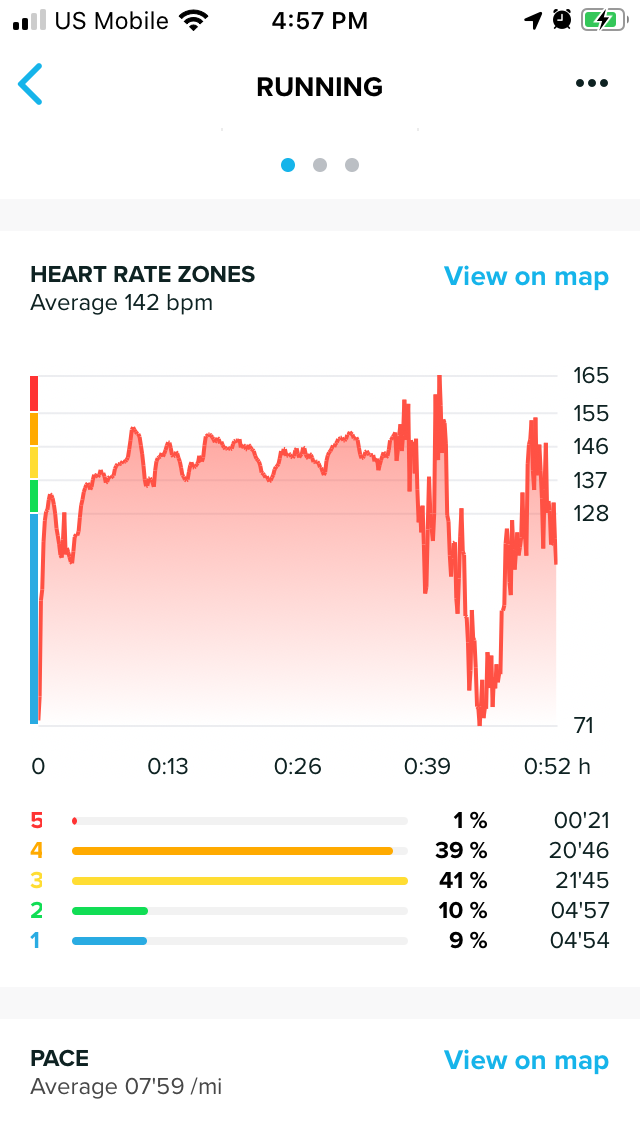

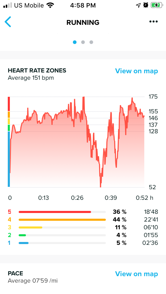

Dying strap, or is the sensor starting to fail?
Here are my last three runs, all 50-60 minutes. The Tickr X is about 2-3 years old and seems to monitor HR fine for the first part, then fall apart during the second half. I rinse the strap after every use and dry it with a fan. I replaced the battery a couple of months ago so I don’t think that’s the issue but I also don’t know how to check battery charge / status.
Based on where the HRM starts to lose monitoring, do you think the strap is getting loose (i.e, time for a new strap) or is the sensor failing? It was humid during these runs so my shirt was dripping wet by this time (reference the comment above about their HRM reading erratically once the terminals got soaked).
