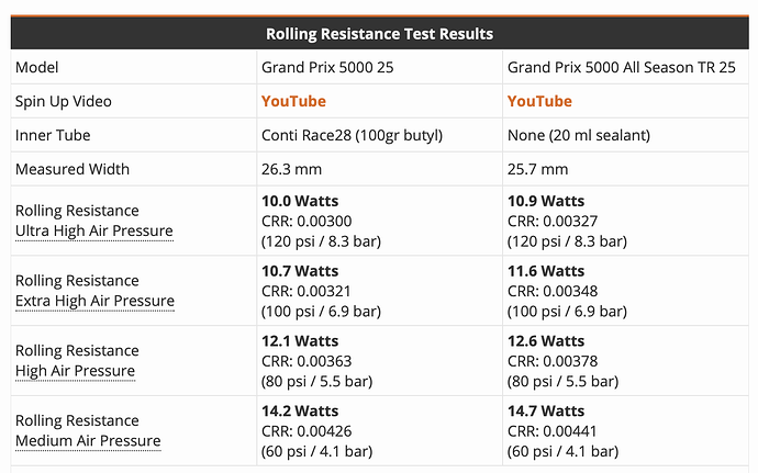

Haha same, I am even looking at the new GP5000 AR TL as my next tyres. I don’t run tubeless but there is NOTHING worse than punctures…
And they are only 0.5w slower than the regular GP5000 according to BRR.
I get around 1 puncture a year with my regular GP5000s, and thats with around 12,000km a year. Riding in Sweden, Spain, Italy, France etc.
GP5000 (orange) vs GP5000 AR TL (blue)
