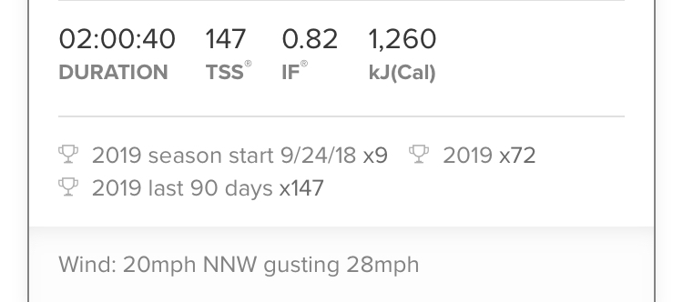

Maybe I’m lucky, I’ve got a lot of hard group rides in the 140-160 TSS range. Here is one from April:
Not too many 2 hour TR workouts with TSS in that range. It’s a lot easier to suffer :muscle:t3: like that outside, chasing rabbits like a greyhound :wink:
