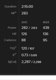

Yes, I’ve been consistent 7+ hours/week since late 2020 and each year have pushed my aerobic base higher. In power terms (at fixed heart rate), something like 150W season 1, 170W season 2, 190W season 3, and lately closer to 200W on a good day (no personal/work life drama). Meanwhile ftp has slowly crept up, from 260 to 275+.
