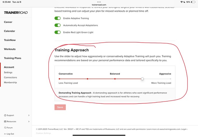

When all the yellow days was getting a bit annoying changing this setting helped.
That’s useful. Thanks.
