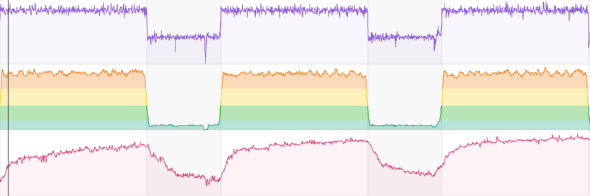

My MHR is around 180bpm so depending on who you listen to I need to get that over 162bpm (90%) or 171bpm (95%) to truly be in VO2max territory - Intervals.icu has my Z5 starting at 163bpm & Z6 at 167bpm. Here’s the last set from Sleeping Beauty. Top row is raw power, middle row is 30s avg power, bottom row is HR.
Max HR is 146 in that section, lowest value is 110bpm.
