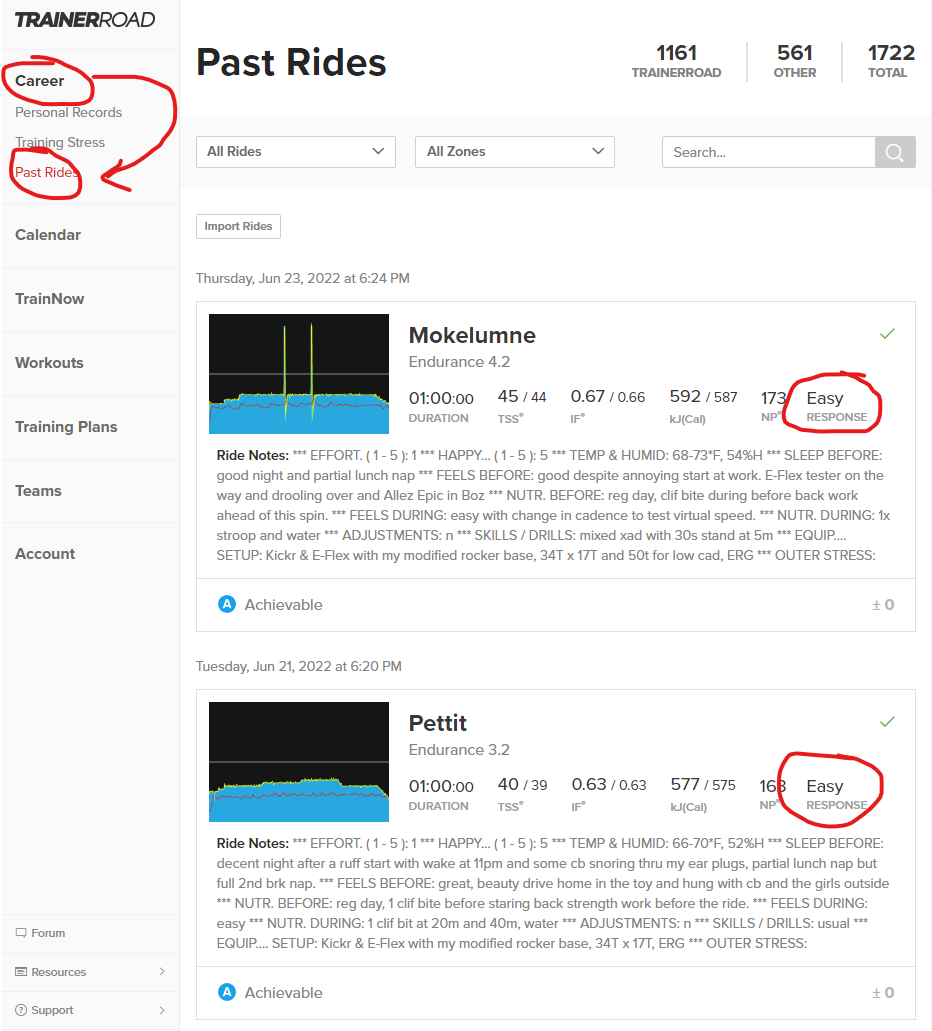

Is there a way to go back and see what I chose for difficulty on a particular workout? My guess is that I marked the last few sweet spot workouts as very hard… But that was a couple of weeks ago, so now I’m not sure.

  • Yup, one quick way is to open your Career on the TR website, then your Past Rides. The ratings are listed right there. You can scroll down and load as many as you want.
