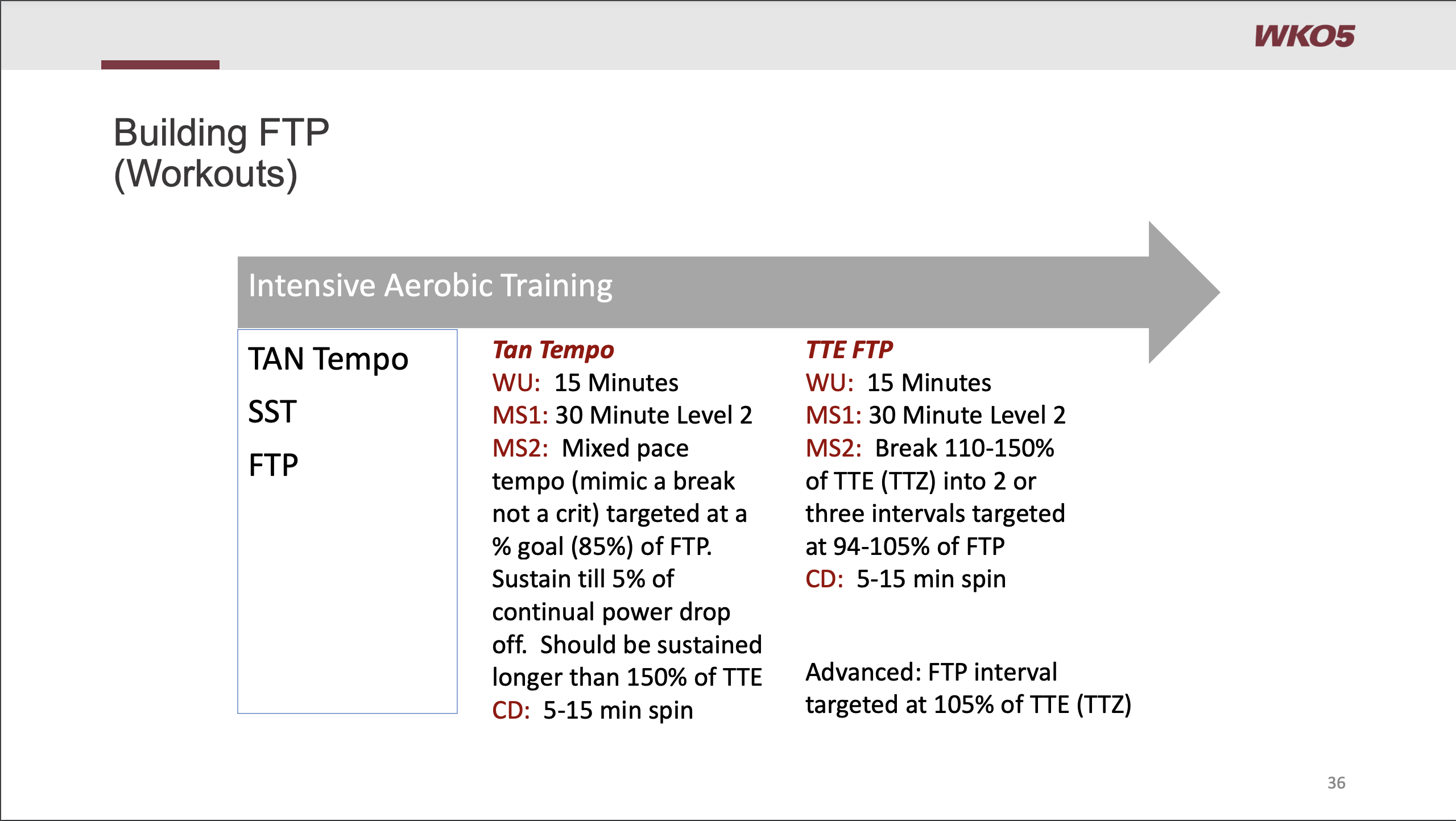

Hopefully we get some people to share their threshold progressions here and we can quantify some things. I’d be curious to know what effect pushing duration @ or very close to FTP has on the actual increase in FTP. Example: will doing a progression at 95% of FTP actually improve FTP or will it just improve the duration at which you can ride at 95% of FTP? (essentially one of Tim Cusick’s prescribed workouts from the WKO5 webinar screenshots above)
Or, does one actually need to start riding at 100% of FTP or slightly higher to eventually increase FTP in terms of raw wattage? Seeing as Cusick’s range for the above mentioned workout is 94-105% of FTP, which is a really wide margin.

I’ve noticed my time in zone for workouts is a bit below what Tim Cusick recommends (65-70% of total SS volume in biggest workout.). With 2x60 that is 78-84min TiZ in threshold workouts. That sounds horrible. I generally am going to try to get more than 40min and would cap them at 60min.

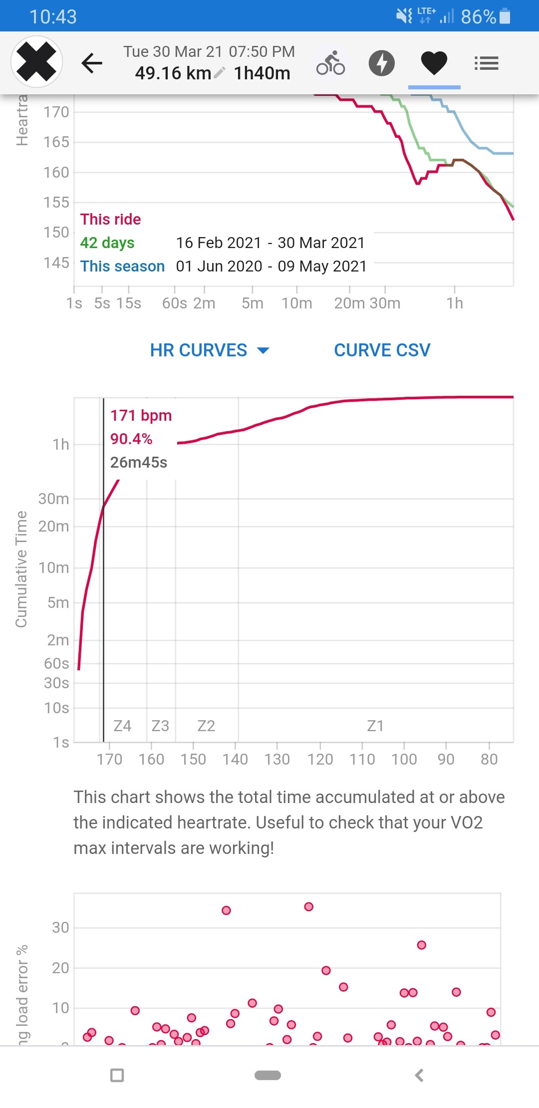

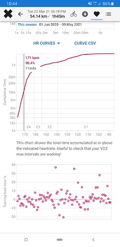

Hey Craig, I haven’t tried one yet. I’m debating on starting with the 30s over, and then under as that will kick start the cardiovascular response and O2 uptake. Either way, these are gonna be tough. The key is to not do too long of sets because these will suck.
For comparision these are 90% with 30s bursts:
2x30:
3x20:
Thank you for the info.
That is kinda what I would expect with the base of the interval being sweet spot / 90% FTP. Not a lot of time at high HR relative to total time in intervals, though the longer intervals are better. But I think the intent of a tempo burst or sweet spot burst workout is different from a closer to 100% threshold burst workout.
