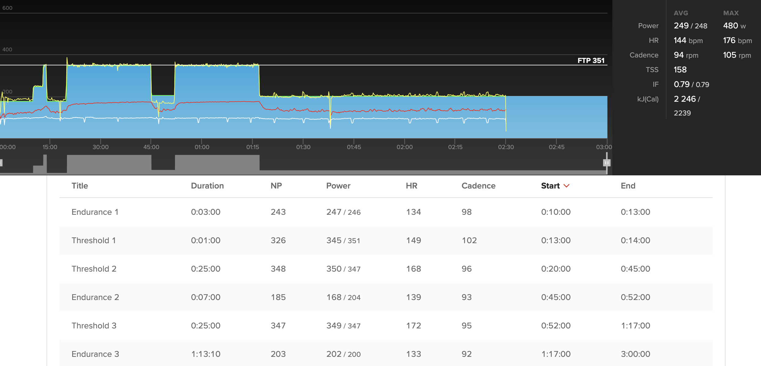

I just finished my extensive threshold progression (shooting for 95%).
Started at 4x10 and finished off with 4x20.
I’m in my rest week now and feel like my zone 2 is +20 watts. First workout of next week will be a KM FTP test.

I got +10 watts out of my threshold progression. The block was four weeks. I think three weeks would have been fine as the last couple of workouts didn’t feel very productive. I actually felt that 10 watt bump after the first couple of workouts because everything afterwards seemed easier.

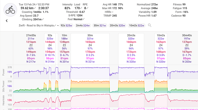

Two and a half weeks after testing my TTE at 40min at 350W, I just completed 1x60. Did 2x25min, a couple hard 30/30 days and lots of easy z2 riding at 190-210W in between, so not that much progression needed. It seems that just riding 13-15h per week mostly easy is enough at the moment to see good gains in TTE :slight_smile:
