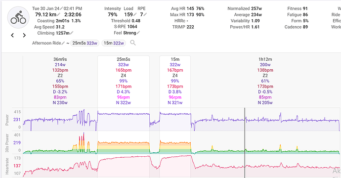

IMHO the best method to improve LT1, LT2 and TTE is long (4h+) z2 rides ocassionally including 10 to 20 min efforts in the begining and end of the ride. Combine these with VBT (velocity based training) strength + Anaerobic intervals immediately after and you are set.
Interesting take and something I’ve don’t in practice without thinking about it bc I was a weekend warrior getting my big ride and big workout on the same day. What intensity do you prefer for the 10-20min effort?
Could you elaborate on this?. I was thinking that 20m max should and longer for special ocasiona and assessments.
RPE about 8. Check power and HR afterwards.
