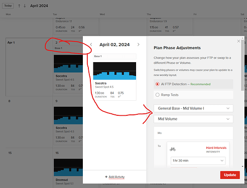

In your calendar, find your A-event and then work back up to find the annotation showing the phase that is closest to your event. Open that and you will see the precise definition to be sure you are actually in a Gran Fondo Specialty phase leading to that event.
Depending on the Experience selected and time to your event, it’s possible that you are not actually in the Specialty phase and could be in Build phase.
Yup. Gran Fondo. Mid volume. Thanks Chad for your insight. I’m contacting the team.
