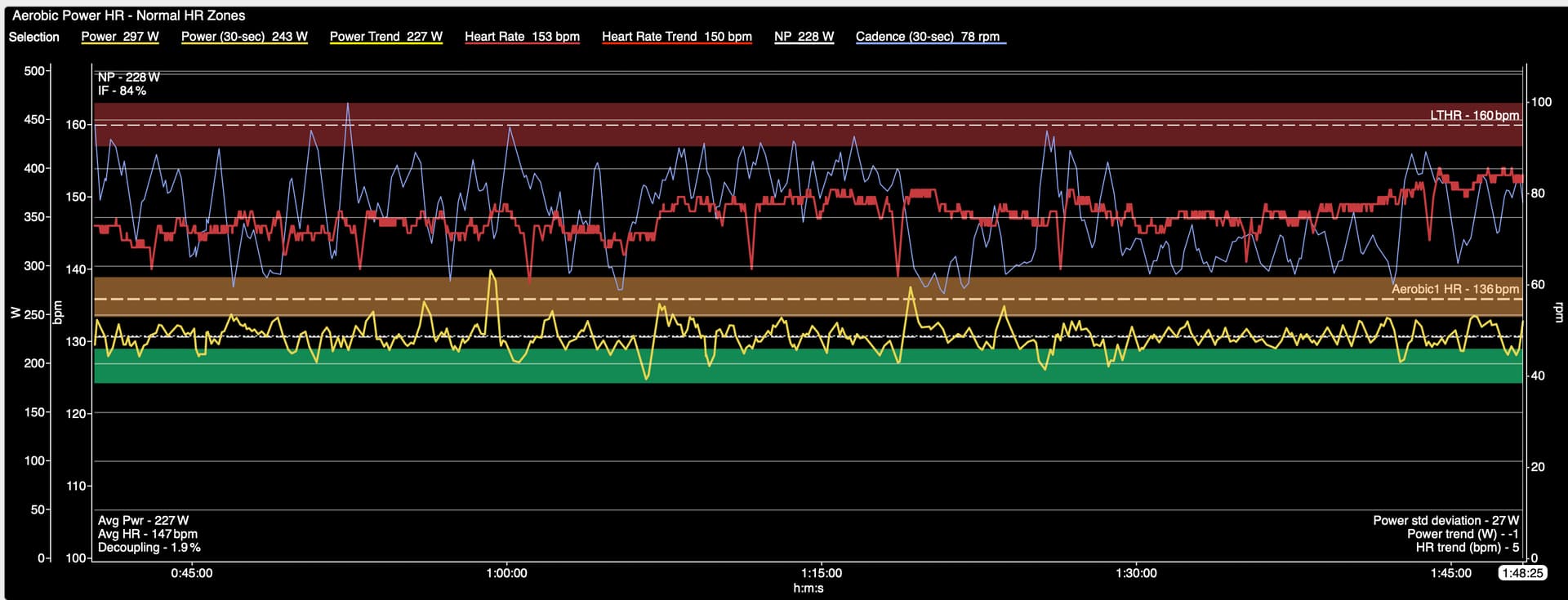

Lastly, during long sub-threshold sessions my HR tends to rise linearly before eventually a gentle exponential rise sets in as decoupling takes hold. My thought would be that this serves as a marker of having exceeded current capacity to the extent where meaningful adaptation will be triggered. As an example, a recent 90 minute sweetspot (88% FTP) interval saw my heart rate stabilise at 140BPM between 20 mins and 80 mins before heading to 150 BPM in the final minutes of the interval.
