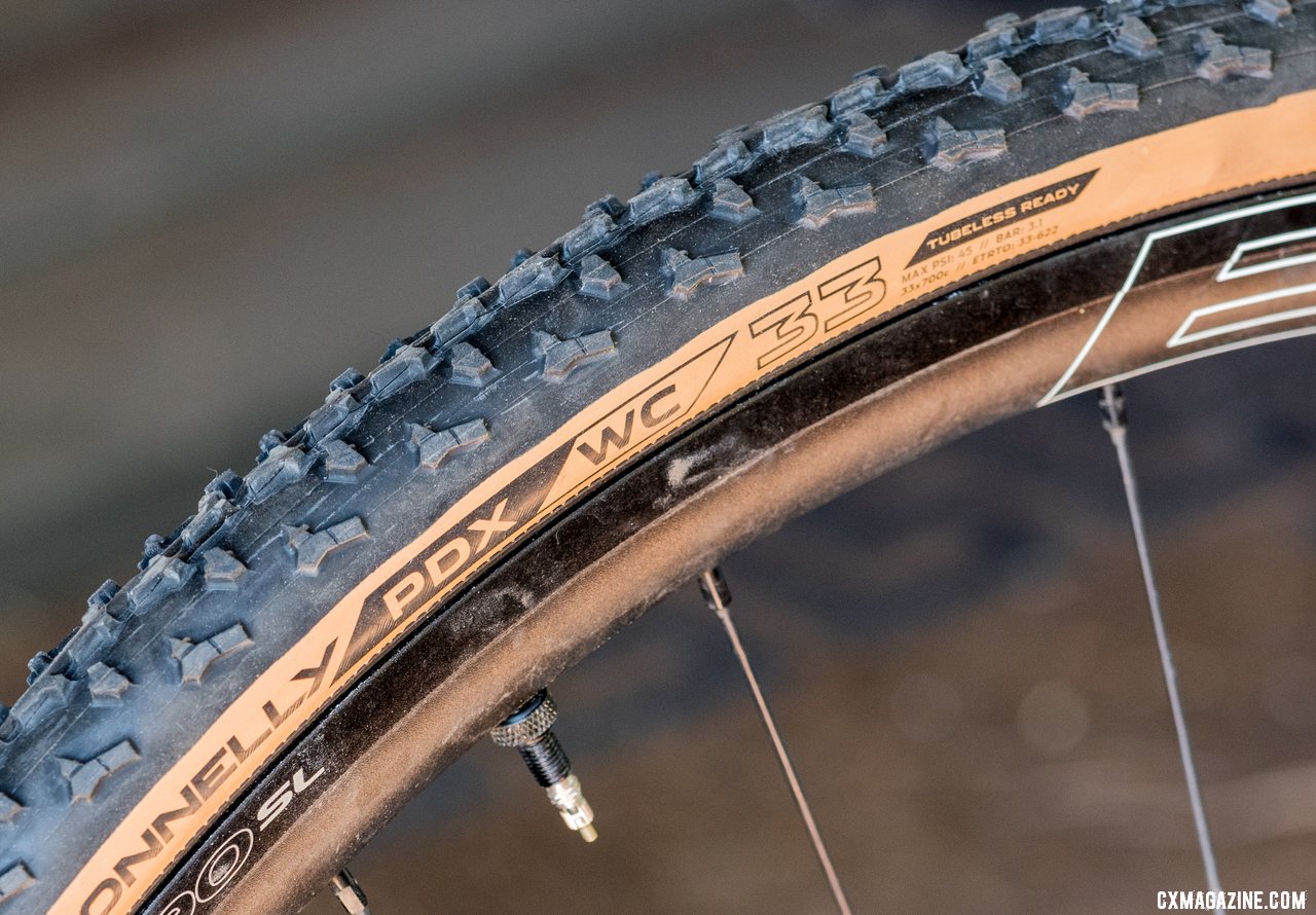

You all have probably already seen this, but it looks like Donnelly is coming out with tubless tires that will conform to the UCI tire width restrictions. I really like how the ‘normal’ Donnelly tires sit on my 23mm wide rims (they often measure 37+mm on the rim), but I’ll probably be using these new tires for nationals (probably the only time in my life I’ll have to worry about tire width).
