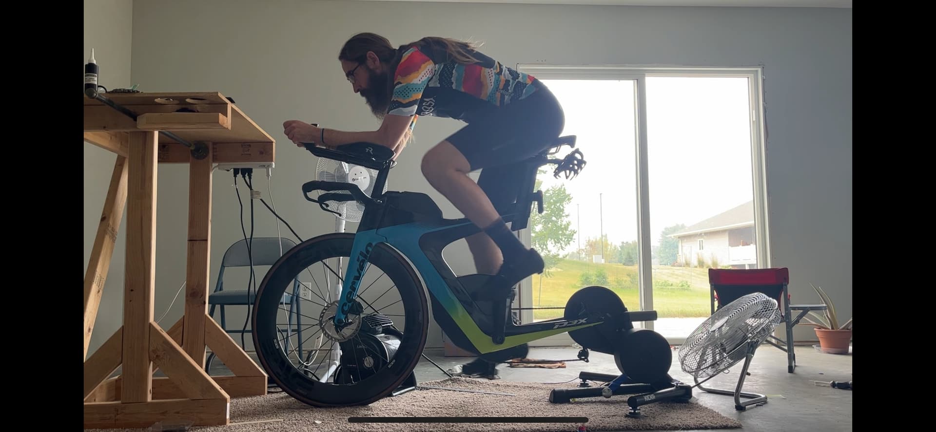

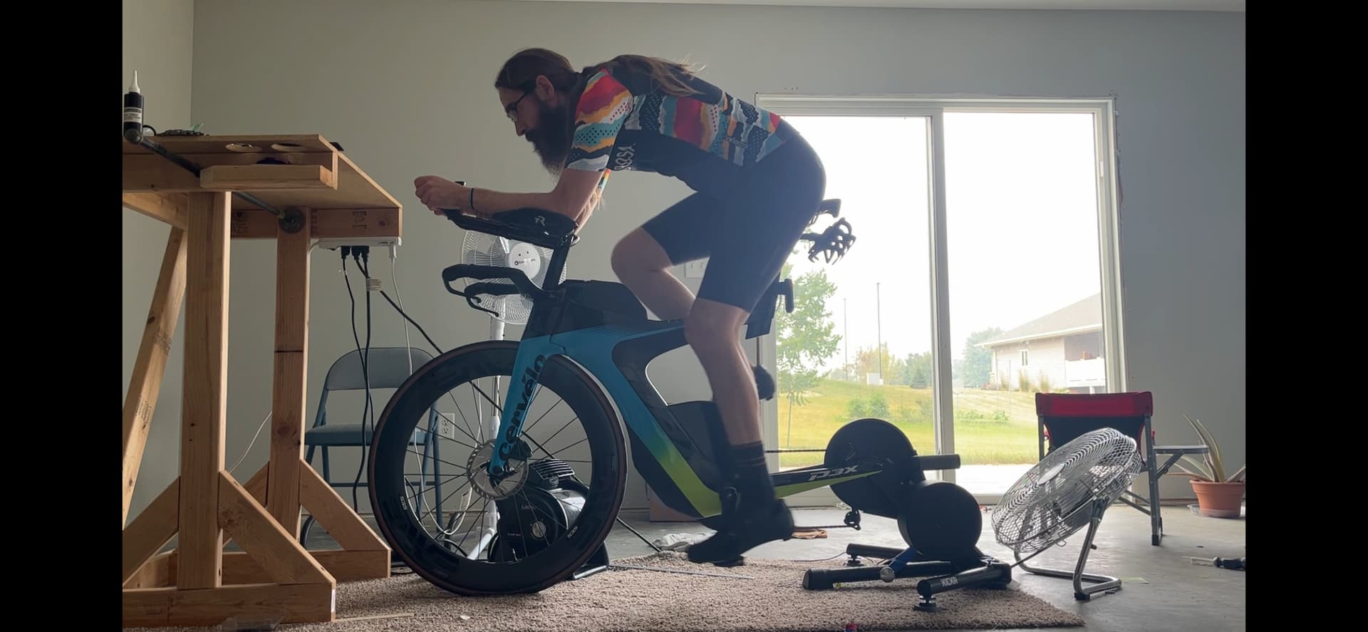

Debating if I should consider moving to a larger frame on my TT bike. I feel like the fit is pretty good, but would like to stretch out a bit more, but the saddle is as far back as it can go, and the extensions are forward as much as they can go. Also I would expect a larger frame would handle better with my weight being better distributed, right?
Admitting that I don’t know the specs or limits of that particular model, your stem location looks SUPER HIGH on an extremely long steer tube. Broadly speaking, this is a no-no from a strength and safety perspective related to the fork.
That safety related aspect out of the way, that bike is at least one size too small for you IMO. I’d have to dig into geo to see about any particular recommendation, but the Reach and Eff. Top Tube Length seem well shorter than what could be appropriate for you. And the frame Stack height is low, leading to my concerns above.
Out of curiosity, how tall are you and what size is the bike?

The riser is right at the max height, It’s not on the steerer of the fork though, it’s an independent riser(like a seat post)
I am 73-74" tall and this is a Large size frame. Next step up would be an XL and that’s as big as it goes. If I were to ride a more aggressive position, it would be a better fit, but it isn’t going to be used for short distance races so needs to be something that is comfortable for hours. I’m just trying to figure out if the money to change to a larger frame is worth it.
That is the geo chart for the bike.
I bookmarked this for a deeper look this morning but in the most simplistic approach possible, the fact that you are at the physical limit of those adjustments and not happy with the fit seems a clear indicator that a larger size would be best.
Depends largely on whether you can live with this current setup maxed out vs wanting to make a change and suck up the cost and difficulty of swapping sizes.
The position is close, I can’t imagine needing much more than 10mm more on the extensions. That said a larger frame would push my weight farther back for the same position and should result in better/safer handling.
  • This depends on what you mean by “handle better”.
See below and note that the XL is 27-28mm longer in the Wheelbase & Front Center, while the Head Tube Angle and Fork geo remain the same. This means the bike will tend to be more stable and hold direction vs wanting to turn and change direction faster in the shorter L size.
