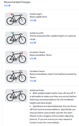

Thanks for this. Does it make recommendations about setback, out of interest?
Here’s an example of the recommendations:
That’s really helpful. I may give it a go. Thanks.
