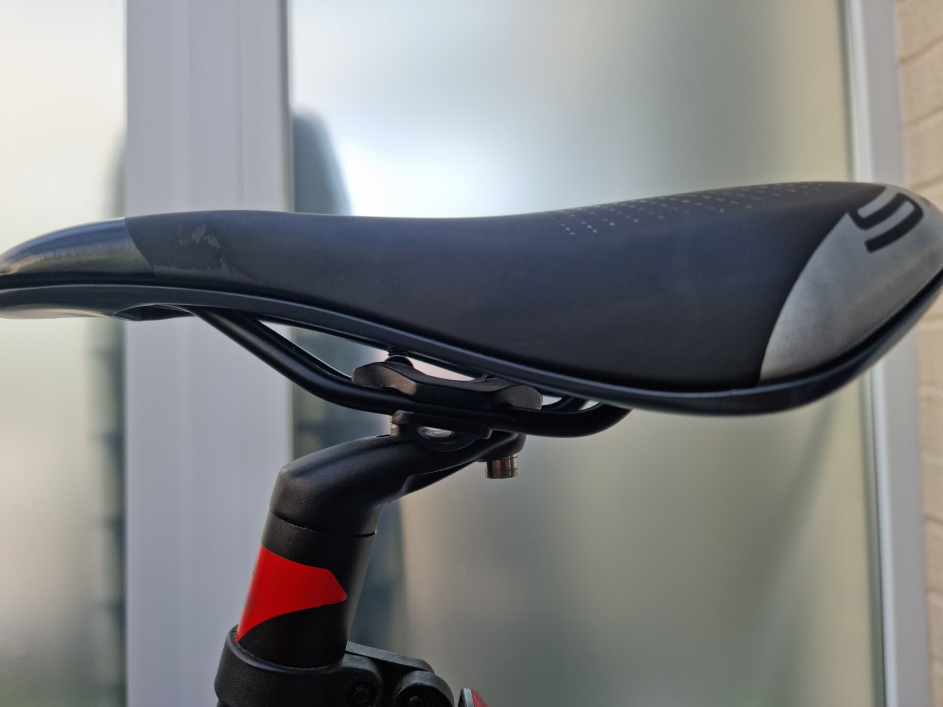

Hi all,
After a little bit of advice. I have thrown this saddle on my indoor bike to hopefully make the 1 hour plus sessions a little more comfortable, having already used it before.
I have levelled the saddle by measuring at the saddle top (made the most sense). My worry is, will this place too much stress on the clamp bolts? I have snapped the front bolt previously (the last time I used this saddle) I’m not sure what angle it was at that time, but would like to avoid a potential seat post insertion going forward!
I’m also a larger rider at around 110kg.
Generally speaking, you have this set in the center of the rail length, which seems fine to me. Maybe the saddle is more rear-biased than others with respect to that rail center, but I don’t notice that without a direct comparison.
If you snapped a screw before, make sure you replaced it will a screw of similar or stronger rating if possible. I’d suspect they use a Grade 5 screw at minimum. Using a Grade 8 could be a way to help ensure you don’t have another failure. Also make sure you torque it to the proper amount. Don’t exceed that rating since you would place even more stress on the screw once sitting on the saddle.
If you are able to do so and still worried about load on the screw, moving the saddle more forward will decrease the loading on the front screw. That change will alter your reach to the bars, as well as function leg extension, so keep those in mind and adjust as needed if you head that direction.
I think chad hit the most important points, but I would just add to make sure you have sufficient thread engagement with the front bolt, as well. It looks like the end of the bolt may be sticking out of the clamp, though…if that is the case, you should be fine. Just remember to get the same length if you go to a stronger grade bolt.
