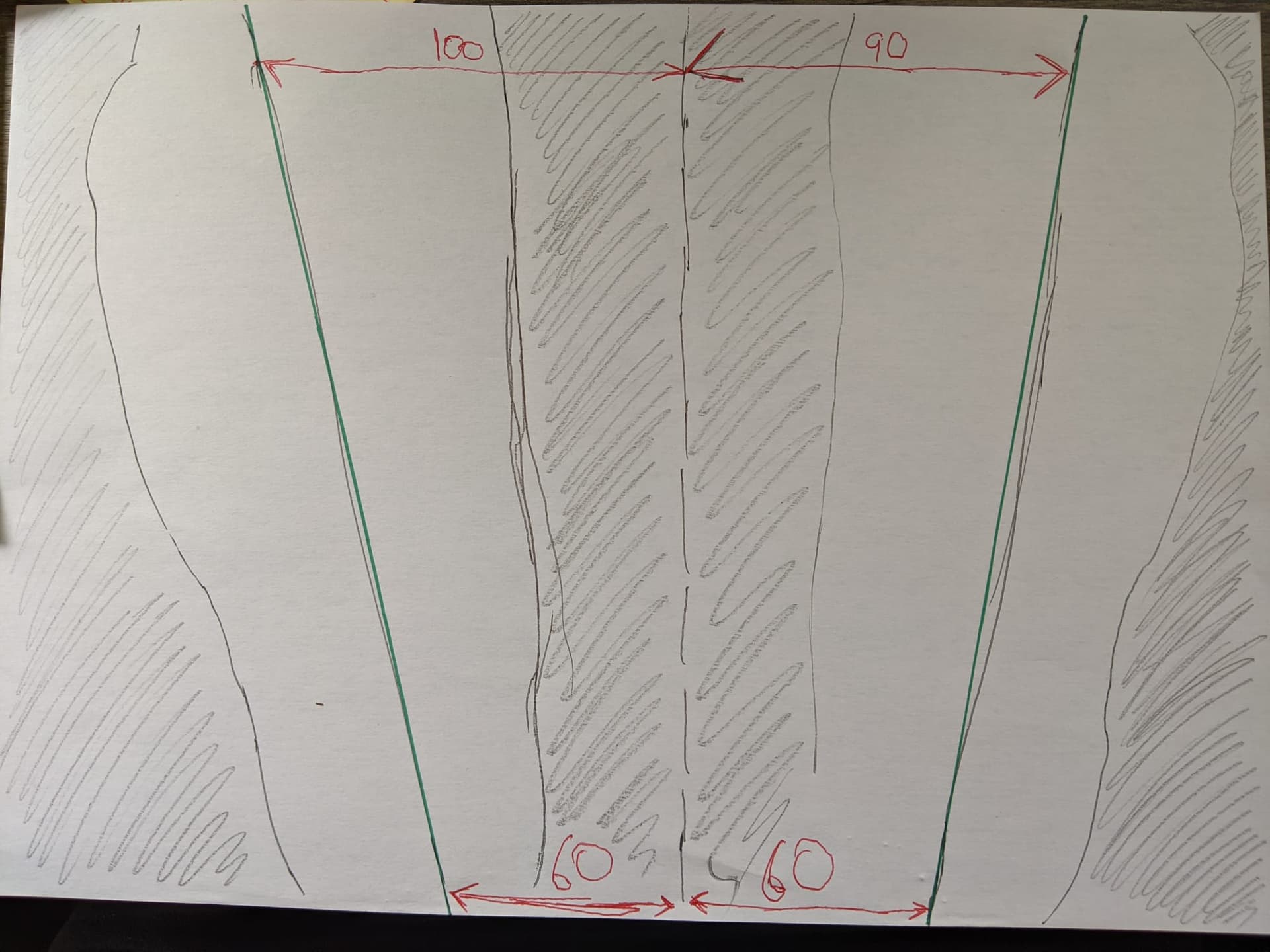

My latest round of spit ballin has got me to this: Could my feet be so wonky that I actually need to have the lateral position of the cleats at opposite extremes?
Example: rudimentary drawing of my feet, but lets assume its mm perfect :wink:
So! If my heels are equidistant from the centreline, my cleat area are significantly different. Would that infer that I could need to use the extremes of the available lateral movement in cleat position to centre myself on the bike and then adjust rotation around that point? Or am I missing something entirely.
In the same vein, due to my collarbone and upperbody imbalances, is it possible that someone might consider uneven placement of hoods to counter it and feel more comfortable, or is it better to use even positioning and force the body to adapt?
Finally…Shut up and get a proper bike fit? :sweat_smile:
  • Probably worthwhile, but you can keep taking swings too as long as you don’t feel like you are into “injury” territory.
  • YES! Symmetry is nice and as a person with some level of OCD, is something I tend to start with personally and in fitting UNLESS there are indicators that some differential is necessary and useful.
  • I happen to have a decent amount of “toe out” for my clipless setups, with my left foot needing the max amount possible with most road cleat setups. Right is similar but about half the angle.
  • Asymmetric setups make sense for those that need them, and you may well be there for that setup need.

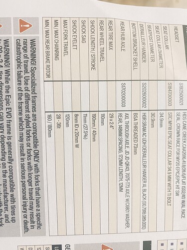

Heres the sag from the owners manual. I’ve set mine up per the online calculator.
Also, I did the static set back to sagged setback measurement again last night.
Static 4.1 behind bb centerline.
Sagged 6.1 behind bb centerline
That’s with me sitting in the bike taking the measurements with a projected vertical red line laser.
OK, I have the 27.5% sag set for the rear suspension.

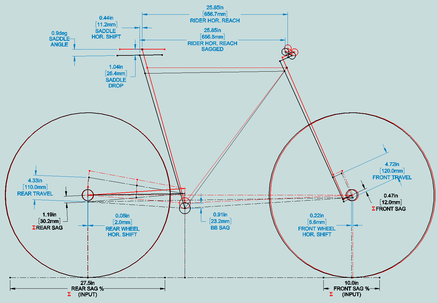

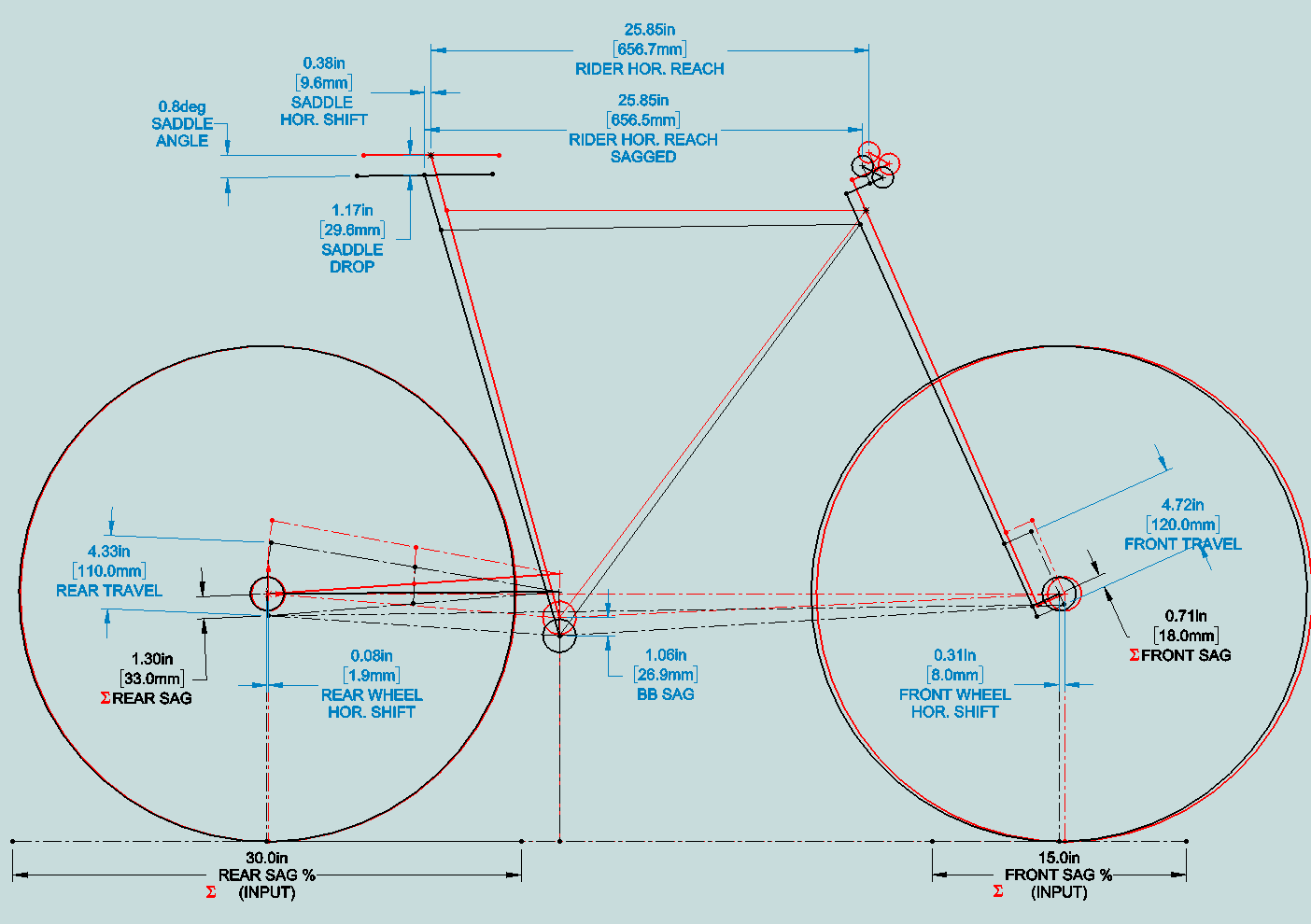

But unless I am missing it, there is no info on the fork sag on that chart. I need to have that for your setup to give you any useful data. Absent that exact info, here are a few stabs in the dark to give some info:
0.1% Front Sag (sketch fails at 0%), 27.5% Rear Sag:
5% Front Sag, 27.5% Rear Sag:
10% Front Sag, 27.5% Rear Sag:
15% Front Sag, 27.5% Rear Sag:
20% Front Sag, 27.5% Rear Sag:
Per the above, a rather undesired 0.1% front sag, I am getting 17.4mm saddle shift & 1.4* saddle tilt. This is while holding the fore-aft position of the BB stationary, so it is the true essences of changes relative to the BB.
The 20mm you are getting may be purely from the sag, but could be from a lateral shift as well depending on how you are restraining the bike during the seated measurement. I do admit that my model contains some estimates of the pivot location, but this should be quite close in a pure kinematic motion result.
