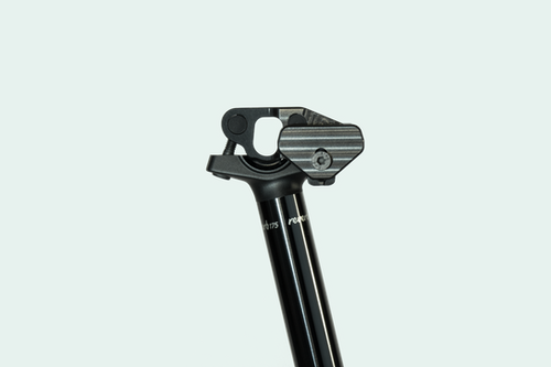

For those that may need this.
Link is not working for me:
It’s an add on to the Reverb (only) to either get you farther forward or farther back on the seatpost.
I know I have my saddle slammed back on my XC bikes and most other bikes I’ve had are the same way. With the STA getting steeper, this could be a good choice.
Hump
OK, but you might want to fix your link. I checked your post and you have the following:
Looks like you have 2 extra letters in your link vs what I found when digging through their links.
The second one shows what I got from the link after getting to the product page you mentioned.
Outside of the link issues, the product is interesting.
That was me picking to share the link from my IPhone straight from the website.
OK, I went ahead an nuked those extra characters from the link in your post, and it works properly now.
