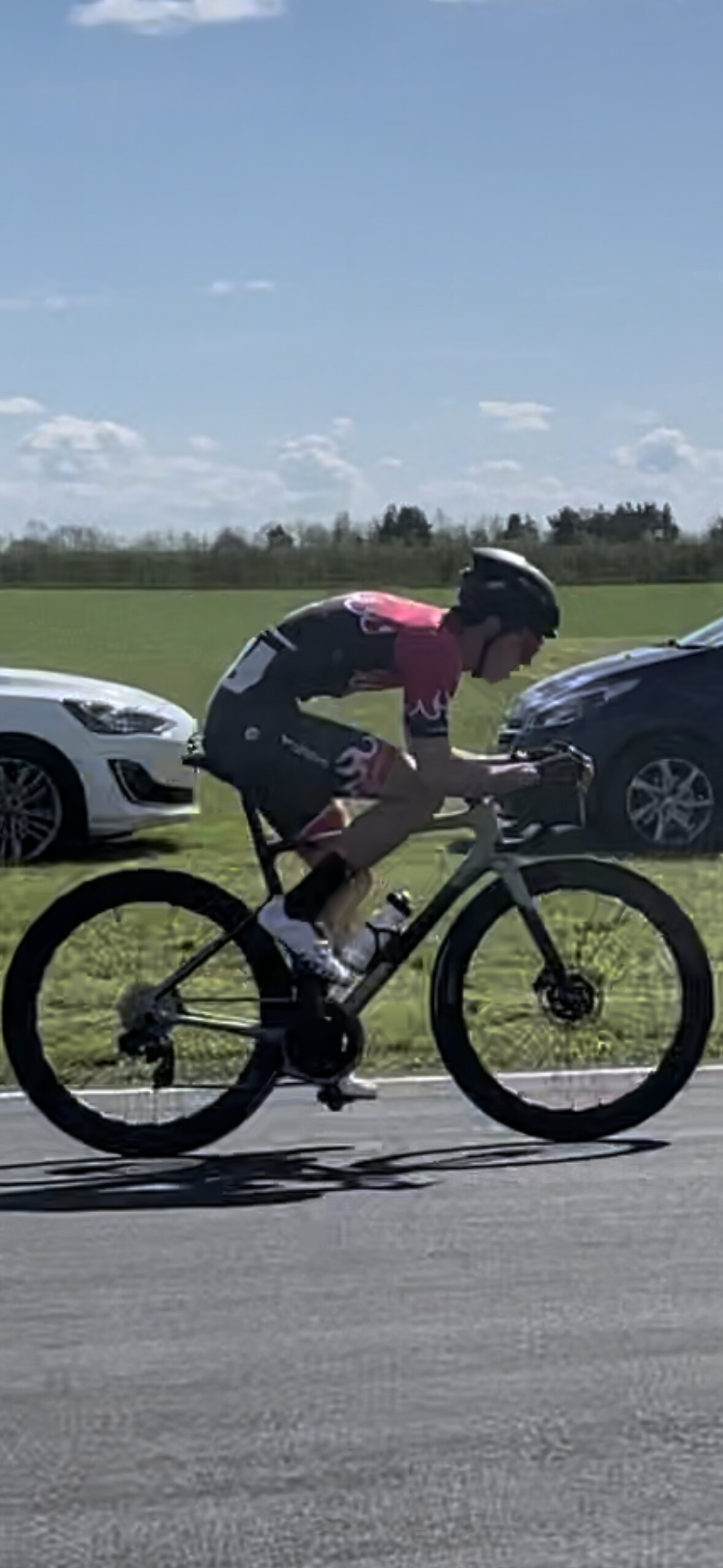

Looking for advice on a road bike fit, with a mind to racing. I’ve been advised I look cramped and my breathing would benefit from adding some length to my stem. I certainly find it hard to get my head inline with my body and feel a tad cramped, though when relaxed and upright the position feels great. Should I try 10mm more? 20mm?
Your position isn’t bad, actually, but could definitely stand to get stretched out a bit more. Your hip rotation looks pretty good, so if you can get stretched out more, you stand a good chance of getting more aero.
What length stem are you currently running?
Thanks for responding, it’s currently 100mm. I had already planned to try 110, but would 120 be a more worthwhile shot? I currently sit on the hoods permanently, no issue of wanting to be on the tops, and when I get aero with bent elbows I feel the lack of room.
I usually advocate smaller changes vs big ones…so I would start with the 110 and see how it looks / feels.
