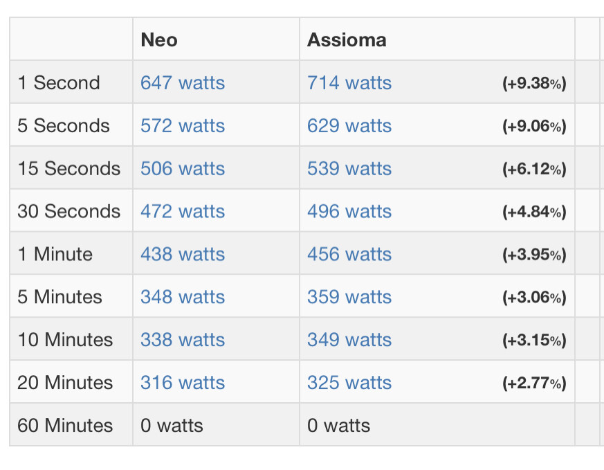

@gpl have you been able to close down your lab (or to put it another way have Tacx come up with an answer)? There are lots of us out there who are seeing similar issues - in my case its a 5-10% difference between my Neo 2T and Stages power meter
Worth noting. I’ve recalibrated the assiomas in TR and it was much better.
I was doing it only on my garmin, maybe that was part of the issue.

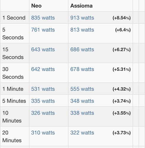

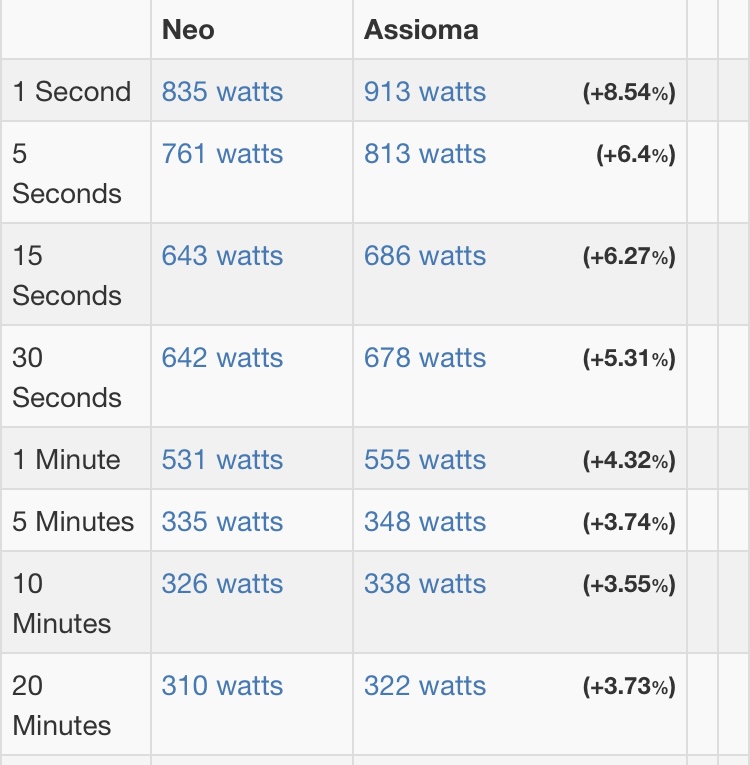

@gpl, so it’s good now for you? Any thoughts/ideas on what could be causing this? Seems weird that the difference isn’t linear as power increases. Something to do with less accuracy as virtual flywheel speed increases? Or maybe cadence?
I had much better results on one test where I did sprints at high cadences, as opposed to the below test rides which were ridden at normal cadences.
my neo one is usually 7-9 watts below my assiomas. the difference is such that i may never be a zwift champion in B grade lol
7-9W makes total sense to me, drivetrain loss and all. I’d expect to see the same percentage difference at all power levels. What confuses me is the much greater discrepancy that I see in shorter duration hard efforts. My sprints are around 2x less accurate than longer efforts (if you trust the Assioma, which match my Rallys as well).
Does this make power matching the best way to get reliable resistance from a smart trainer. I have duos and a Tacx 1 and I’ve noticed big discrepancies so I’ve just used power matching for the past year or so.
Power matching seems like the way to go for most people. I’m just trying to decide what to do for Zwift racing. I don’t want to feel like I’m cheating by cherry picking the higher power source, but I do want my numbers to be consistent inside and out for training reasons, and my other power sources (Assiomas, Rallys, and P2M and Sigeyi spiders) all match pretty closely with each other.
