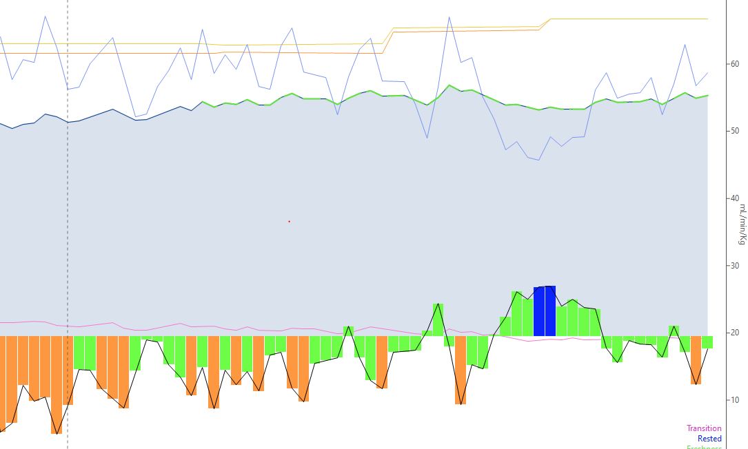

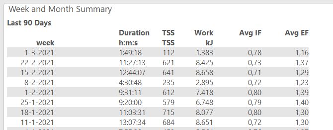

I have also a question about recovery during a SST block. Iam now in the 3th week and normally i should have next week a recovery week, but after the last recovery week (2 weeks ago) it is difficult for me to move op CTL again… Let’s me explain:
Normally my TSS is 600-700 a week. Week 6 i did my last recovery week. CTL 80 and TSB -22. After the restweek i started again with CTL 73 and TSB 16. Now 2 weeks later my CTL is 78 and TSB -4. Now iam afraid that my CTL is again lowering after the restweek. I know in rest your CTL is decreasing, but it takes a lot time to grow up again… Or do i had to long rest?
Iam riding about 9-12 hours a week…maybe 80CTL is the max for that duration…i dont have time to increase volume.
Now iam tinking about to do an extra week SST (4:1) or do i have to stick to the plan and do a half week rest?
