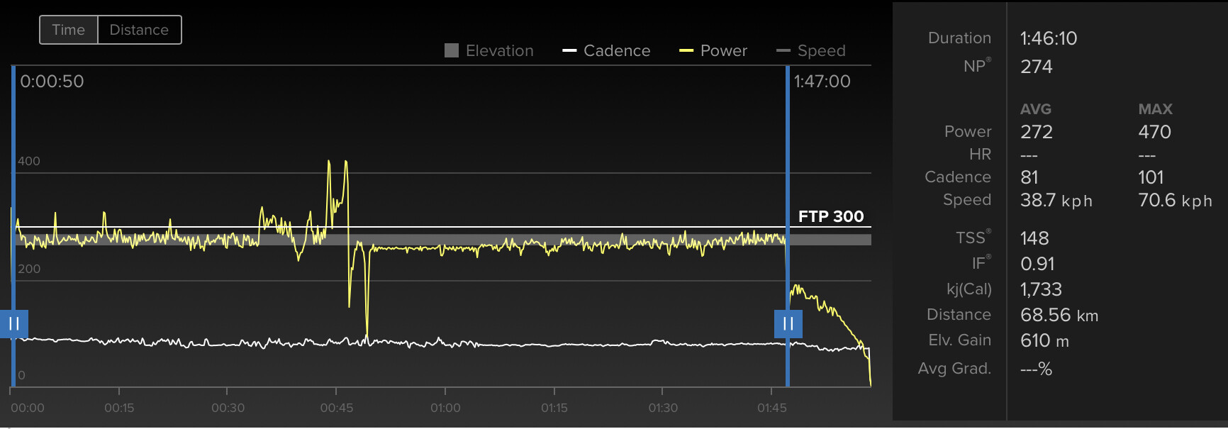

Why not using Zwift races with trainer difficulty on 0% so you can give a stable effort.
This is a race a couple of weeks ago with the first 31min 290w. The VI is 1.002 so i think sustainable…
This is the Joe Friel point-of-view from 2011 blog post:
ā€œAll that’s required is running (or riding) as hard as you can possibly go for 30 minutes ALL BY YOURSELF. It must be solo. Doing this as a part of a race or with training partners will change the outcome. Your number will be too high. If you want to do it with others or as a part of a race then you need to make it 60 minutes duration instead of 30.ā€
Source: Determining your LTHR - Joe Friel
Something to consider.

I know that when you ride outside with others you cant do a good FTP. But in 2011 there was no Zwift. What do you think about TT race in Zwift, or normal race with 0% trainer difficulty, so you can do a flat effort. You ride by yourself and dont use other riders…
In a Zwift race or TT race i can go a littlebit deeper to reach physical max…
And the reason for this - it’s a different environment than what you are going to train in.
I’m jacked up to do a race, adrenaline, etc. That absolutely lowers RPE and allows me to perform better. There’s no way i’m in the same mindset at 5am
If you did it in Zwift you should be able to do it solo again. Use the second number.
