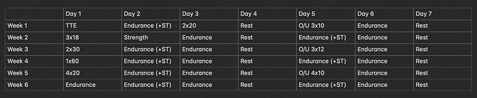

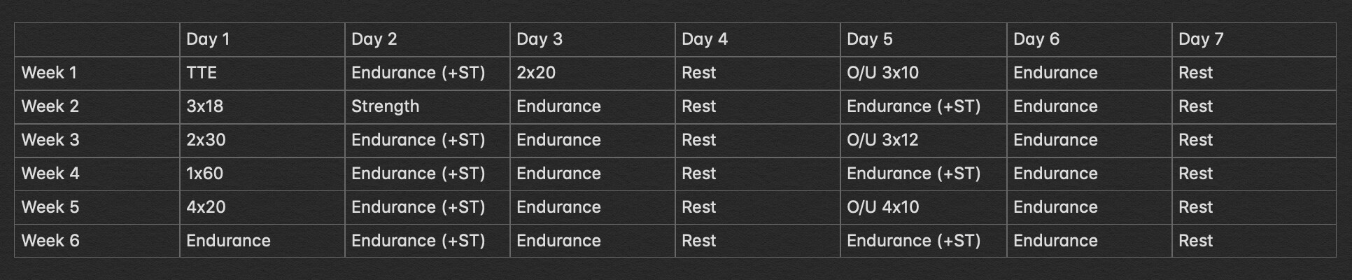

I’ve scheduled out the first 3 weeks of my extensive phase. It looks okay on paper…
Plan is to progress to 50min Threshold and 75min SS at my new FTP (post-vo2 block). Depending on stress outside of training, how I’m feeling, and based on my last SS-only extensive phase, I hope to get a little bit longer than that. We’ll see what happens :slight_smile:
I found some extra time on Tuesday mornings, so I’m going to make those the longer days with threshold work built into them. Gym sessions on Wednesday and Friday 3+hours after riding. I am rarely to ride on Sundays, so that will be a full day off. TSS avg is around 650 per week, 10-12hrs per week on the bike. If short on time, I’ll make my Tuesday rides shorter, and if I have extra time, I’ll make Saturdays longer… Unfortunately, the weather is looking pretty bad here for the next few weeks, and with school and work I’ll be lucky to get any of these outdoors. Hopefully can find a good series to watch :slight_smile:
Love the long endurance with efforts:) this are hard workouts but highly enjoyable. I would only change tuesday - 5x10 for 3x20. I find better results from longer intervals - but this is personal observation.
This is my reasoning and try to fight it. But if I have a choice I would always choose less intervals and longer time. Not to mention that I like the feeling of beeing in the zone mentally during this efforts. So probably I am a perfect TTer without watts and CdA of a barn :smiley:

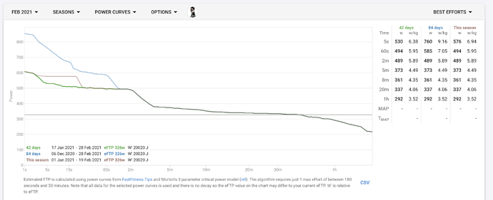

Yesterday i would do 3x20 SST but failed. After increasing my FTP from 280 to 292w i have problems to finish a SST workout. In the morning i did strength. My FTP is from WKO5 with a well fit pdcurve. My TTE is 43min. Maybe i start to hard with 93%. Is it better for me to do the blocks in the 88-90% range? WKO5 give for SST 257-278w.
1th block 20min avg 272w (93%)
2th block 11min avg 268w (92%)
3th block 11min avg 264w (90%)
Yeah, I’d say do them at an intensity you can complete, since getting the time in zone is more important than hitting an exact power. Also maybe ride before strength training, unless strength is your priority right now.
Because of work it is for me not possible to riding Zwift 1.5h during the lunchbreak, but i can do 45min strength, thats why i do strength in the morning and riding in the evening.
