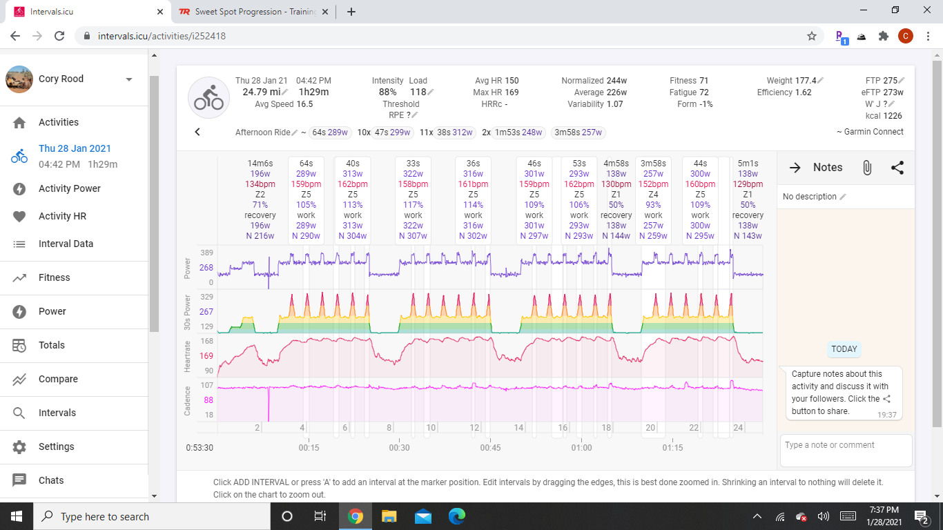

Tuesday’s Threshold:
Tonight’s O/U
I started with the patio door open from the start and faired much better. Didn’t even notice any lingering lactate for more than a few seconds on the Unders until the last block. Tempted to turn them up to 92% for next weeks session, but afraid doing that and adding more time might be too much. Honestly, These were enjoyable and passed the time quickly, but I fear they may have been too easy…
