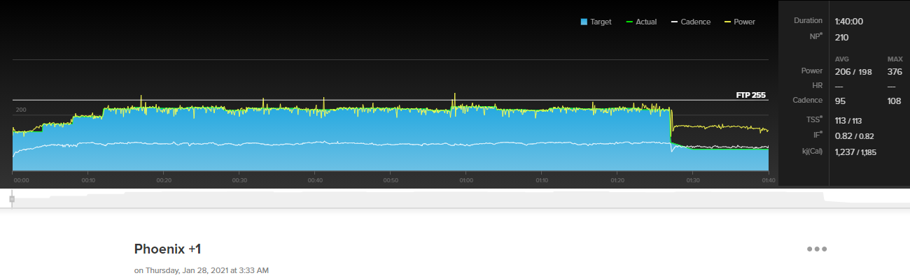

Did Phoenix +1 today, so 1x 75 minutes at 85-90% FTP, going to do Spruce Knob +3 for 3x30 @ 85% next, then maybe Echo +5 for 2x50 @80-90% before Gibraltar+1, 1x90 minutes at 85-90%.
I do have a question: Why are all my intervals slightly below the target? I didn’t watch the metrics today, but just rode on feel and endured the effort, kept cadence at 95-100, but all my intervals are a couple of W below the target, eg. 217/219, 224/227. etc. How come? Trainer was calibrated.
My ERG intervals are often 1w out when I review afterwards - think this is due to rounding of FTP/% targets in intervals. Not sure if that would affect it by more than 1w though. Nothing to worry about though
