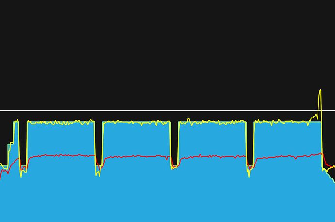

Did 3x35 today, although I did backpedal for a few seconds in the final interval. Looking back at my power curve from the summer, I’ve put 40 watts on my 2 hour power since I started doing these long SS workouts. Pretty cool
