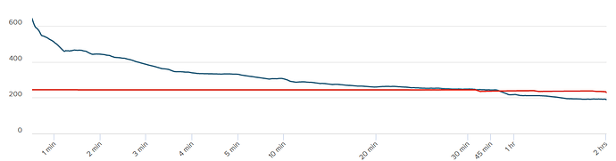

One of the common criticisms of SST is that it’ll artificially inflate your FTP, but you won’t be able to hold it nearly as long as a “polarized” approach would have you do it. This thread shows that plenty of people (including me) can build a strong aerobic base on ~10hrs per week that gives them a high FTP that they can hold for a lot longer than your average TR SST plan will. The key is building extensive endurance at relatively high power, rather than just continually trying to push one number higher and higher and higher for the benefit of ego and harder and harder training sessions.

Following day: 90mins @ 304w. Felt completely sustainable - had I fuelled/had the time, could have have held out longer.
Not posted to brag, so much as reiterate the results I’ve got since really focusing on extended TiZ and interval length since earlier this year, and specifically this winter. Being able to cruise along at a power which would have been intimidating pretty recently feels so good. While there’s obviously physiological reasons that the longer progressions work, so much of the training is mental: when you’ve never done more than approx. 20min intervals before, it feels like that’s the limit. It really isn’t…

Only using your post as an example of the general issue. I wish we all in this forum use w/kg instead, it would give a lot more context to the random numbers. Cheers!
I politely disagree. You skinny guys can’t get all the privileges :rofl:.
Why? W/kg pretty meaningless in flat races/rides. It also isn’t great when it comes to tracking power progress, because you also need to know the weight changes. Keep it simple, and go by power only.
The thing here is to not compare your numbers to somebody else’s without even knowing them. Yeah I do cry too at the thought of somebody doing 90 minutes ‘sustainably’ at what is close to my MAP, but we are all different and I won’t ever race him, so what’s the point?
yes, we are all different, but size is one of the differences that is trivial to control for (age and years of training, altitude are others). The point is that the gain on information and context far outweighs the cost of adding the important denominator.
74kg! Forget that TR doesn’t show in the stats like elsewhere - though racing for TTs this year so not looking at the scales atm…
(…and I ride with far too many 5 w/kg riders or close to 400w monsters on the TT scene to feel even vaguely fast)
