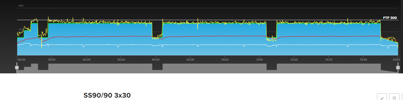

Just wanted to brag about this bad boy, big progression for me personally to get here. Mentally kind of a miserable workout but doable.
Probably because that’s what TR sweet spot seems to be when you get to a certain progression level.
I did wright peak and trainer road said we will increase your ftp for you doing that, 10 days prior to my actual ftp test date. That is so nice of them.
It’s crazy to me that doing 3x30 at 90% automagically means your FTP went up. Computers. :laughing:
Yeah, a bit weird to have that assumption :man_shrugging: it probably works well for newer riders as doing ftp/SST work can raise ftp but when your more well trained that largely stops working in my experience. For instance I just finished a block with a 2x60 at 90% but when retesting ftp it remained the same as the start of the block, my tte just went out by a lot.
I’ve seen it go both ways: you can do 3x30 or 90min at 90% because FTP is now higher and that 90% is really 85%… AND because you can just legit sit at 90% for 90 min now, but if you tried to ride 40 min at 105% of the current FTP thinking your FTP had gone up because of that, you’d blow up. So yeah, it’s a bad assumption for some people, IMO, as you mentioned particularly people who are already pretty highly trained.
Yep, when I first started years ago I would have that experience. Do a lot of SST and have my ftp increase, now all it does is push out the tte and I need a block of higher intensity vo2 work to get that bump in ftp.
Had the same thing last season and attempted to see if my ftp went up, my spectacular explosion part way into the test showed me that no, no it had not gone up :rofl:.
However I was much more able to hold that same ftp after a longer ride or after lots of higher intensity in a race than before pushing out tte.
I tend to think of it this way… if you have well developed fitness then you avoid the vo2max slow component and 90 minutes isn’t an issue. Those with less well developed fitness might have 1x90-min at 90% interrupted by the slow component.
To use your phrase, I’m not a “super advanced endurance athlete.” But can show you examples of 1x90 and 1x120 at 85% without an increase in ftp. And 1x50-70 minutes at FTP - without an increase in FTP.
I like to think I have decent fitness. Last week I did do 3x30 at 90% and nailed this 3x30 @90-92% today after my highest tss week of the year. Maybe there are other factors at play I’m not aware of. Either way stay on the grind everyone
