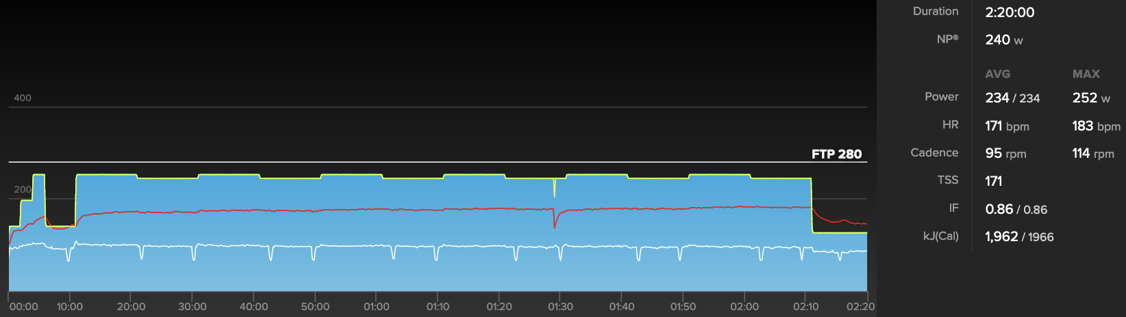

I built out to 4x20 (2 minute rest) in about a month. It didn’t feel very hard but SS work never really feels hard to me. My biggest limiter is sitting on a trainer for 2+ hours. :slight_smile:
