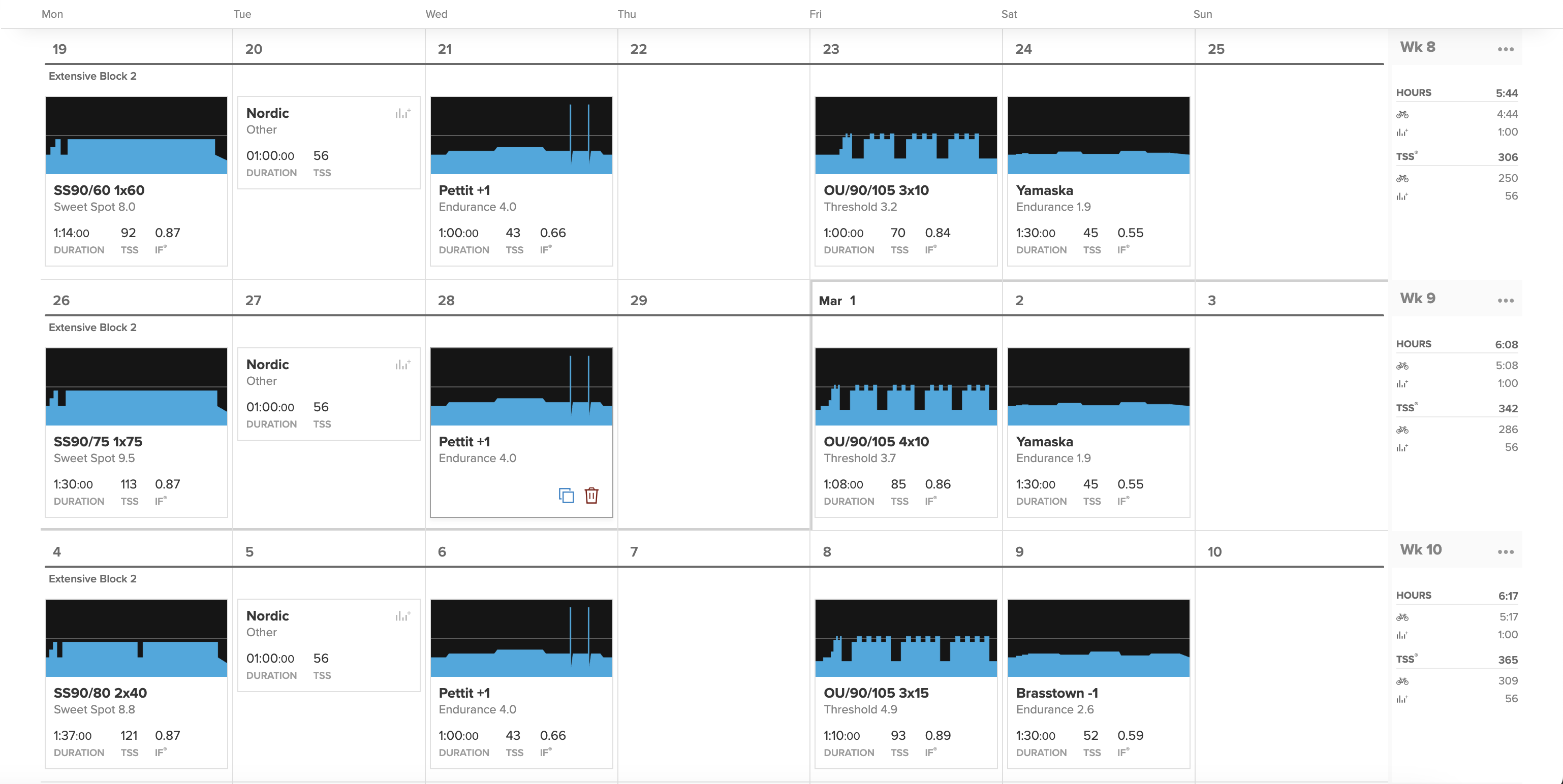

Okay, nice confidence builder after having to cut it on Monday. Was feeling good so I bumped it up on the last section. I quite like this style of mixed intensities for sweetspot work: the lower intensity parts make me focus on relaxing and riding easy even at a hard intensity. And the highest intensities are higher than I typically ride for sweetspot. It also breaks up the monotony, which is definitely an issue I have when staring at blue bars.
Not exactly sure yet where I’ll go for Saturday’s workout. In my plan, I was doing 4x25, but that was with the assumption I’d gotten to 90 min TiZ, which I have not.
Only thing I don’t really like with undulating efforts like that is that it makes it harder to compare heartrate of the first half with the second half of block like that.
Why not just give it a go at a moderate sweetspor effort and see where you land?

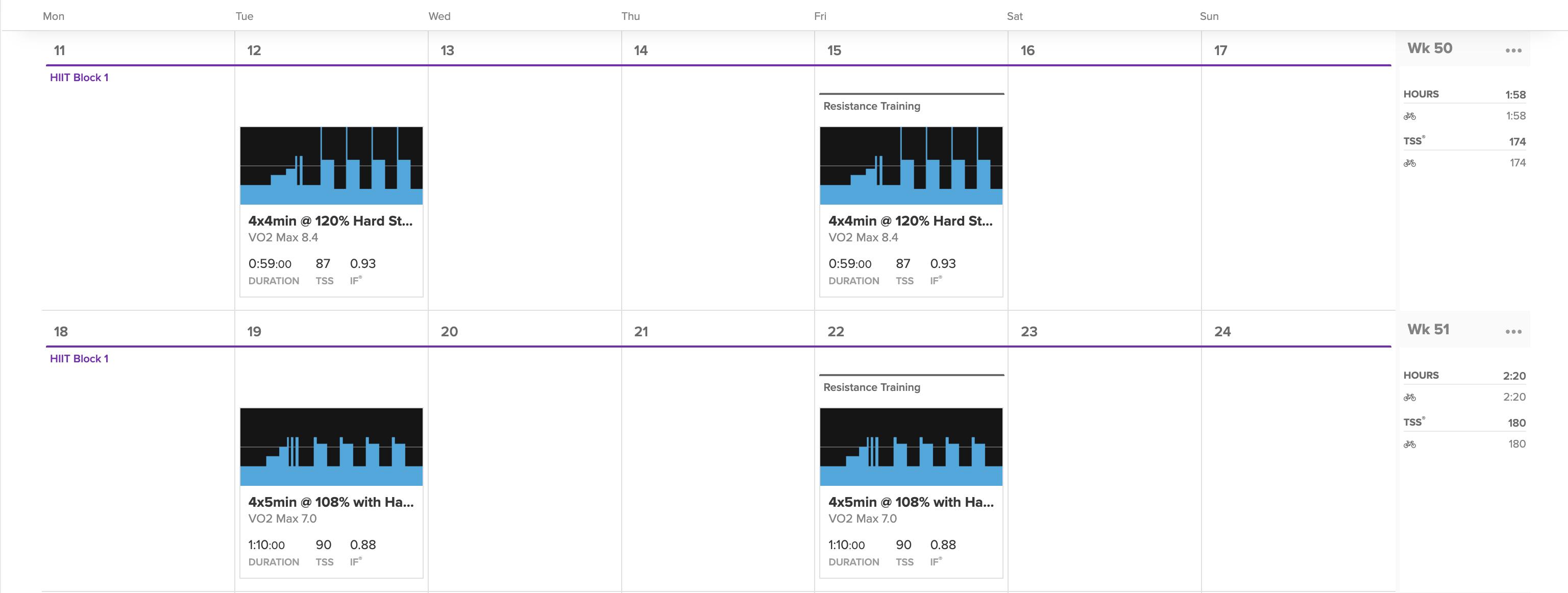

So would doing hard start sweet spot and threshold efforts be worthwhile for that as well or does it need to be pure VO2max?
Right now as its off season and I’m ~5 months away from any racing am focused on sustained power, flat intervals like Log In to TrainerRoad
But wondering if as I approach spring I should start swapping SS and Threshold workouts for hard start SS and Threshold like Log In to TrainerRoad and Log In to TrainerRoad
Hard start threshold/SST isn’t going to make a difference. I give those generally as race prep stuff. Physiologically there’s not much difference: it’s still endurance training below threshold and you need VO2 work. VO2 work is not just “ride some in zone 5”.
Okay maybe I won’t bother with them at all then as I expect they would add a fair bit to my fatigue.
What about of doing them (VO2 + Threshold) mixed, instead of a block?
Something like: 1 Vo2 + 1 Threshold progression per week, fill the rest with endurance and group rides totaling 10/12hrs (500/600TSS). Is that a good approach for, I’d say, 6 weeks prior peak?

and what would be a block, 4 weeks with 3x1 approach and 2 HIIT weekly?
I don’t think I can handle more than 2 HIIT, physically and mentally. Sometimes I just want to go outside and ride.

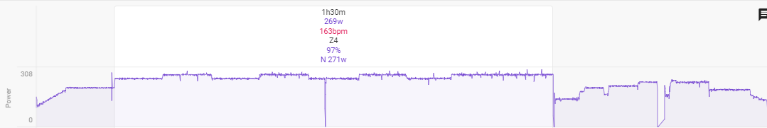

Because for me. I can already ride 1x80min at 92-93% with limited cardiac drift. I even can go longer (but I was at the top of Ventop so…). Is the focus on weekly TIZ at SST maybe the goal and try to increase that weekly time. Or should I focus on working towards 1x120min?
Yes, I do long granfondo’s or zwift stage races. But I think (or maybe I just have to test it) I could already do 120min at SST? 90% I am almost sure off…So maybe should I start a treshold progression? But I am the kind of tempo rider that is very good at tempo/SST but give me 10-20min at treshold or a little above I struggle :slight_smile:

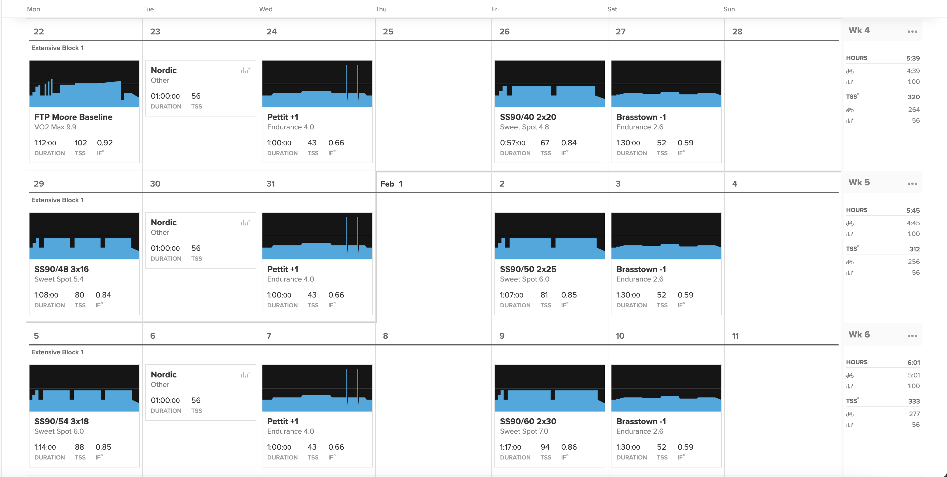

My plan is 3 blocks of 4 weeks, 3 hard 1 recovery:
1 (started 2 weeks ago), focus in endurance and some SST/tempo, nothing too much structured.
2 tempo progression to finish in 1x60min +/-90%
3 would be 1 vo2 (5x3 > 6x3 > 5>4) and 1 Threshold (2x20 > 3x15 > 3x20)
This would end in Feb 11 (hard of the winter). From this point I’ll measure where I’m and see where I need to go (improve/specificity), TiZ, FTP, vo2, etc.
