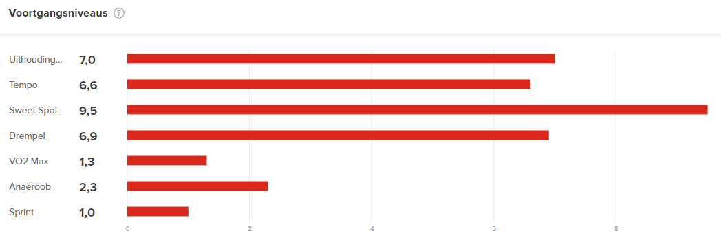

Inspired by all you crazies I started doing some longer sweet spot intervals and progressing through them. Started out with an easy 4x15 minute two weeks ago, then 3x20, then 2x33 (all at 90%).
Because it felt like I was simply growing more confident in my abilities to sustain these longer intervals I decided to punish myself a little today and did 1x70 @ 90%.
Going to push it out towards 1x90 over the next few weeks. I have a feeling I could pretty much do 1x80 in a few days already, but mentally I really need a breather right now. :laughing: They aren’t much fun and I need to focus on sustaining the power just enough so I can’t really watch any series… Any tips for making time pass more quickly?
No tips on passing the time… just get the work in.
