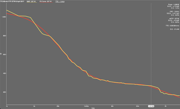

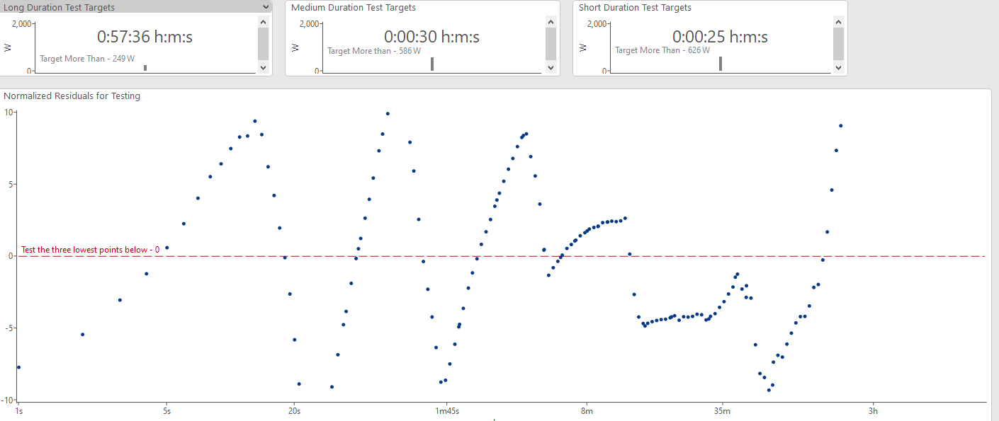

Any thoughts on FTP prediction based off of long SS intervals.
I expect there’s not a lot of sample data to build a sufficient model from. At least from looking at Intervals ICU that’s my thinking.
If you maintain a power duration curve in intervals, WKO, etc., you can probably interpolate decently well.
But the best way I’ve experienced is by feel. When it starts feeling more like tempo and you’re really able to extend the duration, good chance it’s gone up! And then I would want to test or validate it some other way anyway, even if I had it interpolated from PDC data or another method when I was just riding sweet spot.
Here’s the kicker: even if it goes up mid-block, it’s not that big of a deal to correct it. Just extend the duration. Instead of doing 90%, you might be doing 87%, but if you do it longer, you’re still getting the training benefit. I just went through a nearly 12-week cycle where I didn’t update my PDC, and instead just rode threshold (and thus sweet spot) by feel with HR as a backup to power. Went great. Just set some all time short power PRs today, and all indications are about a 10W gain in FTP over my initial base phase before even trying to work FTP…
