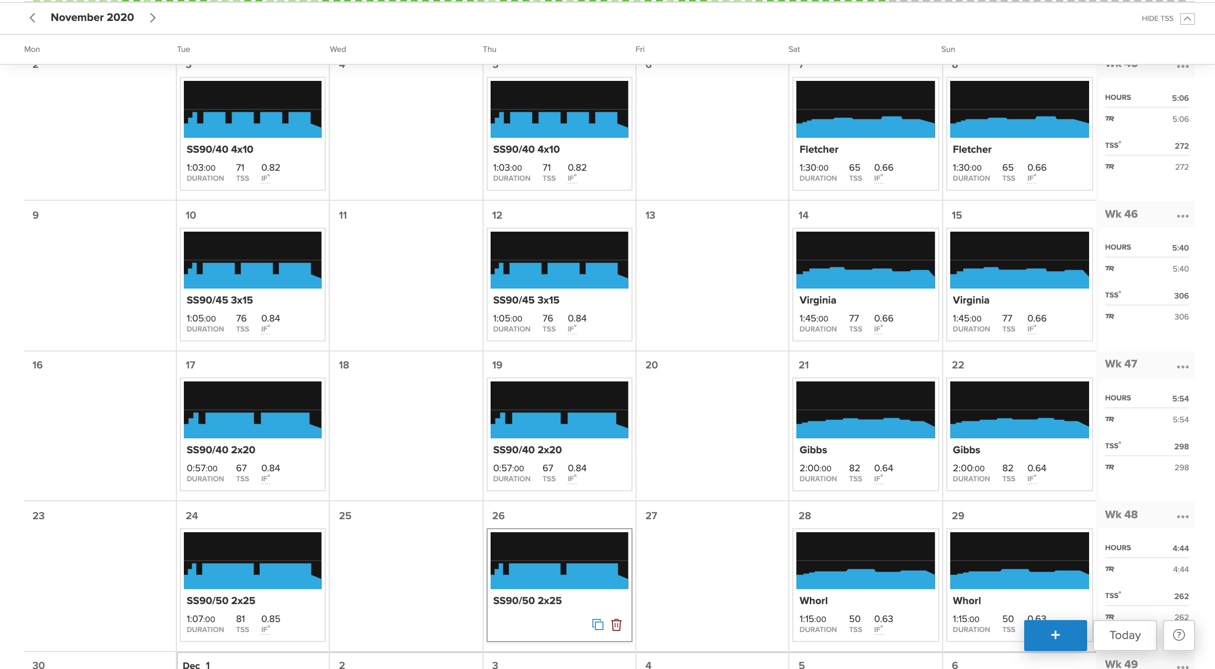

I read a bit into Sweet Spot Progression and came up with the following training plan.
I’d like to combine sweet spot work with a bit of traditional base on the weekends - during the week I just won’t be able (or want to) commit to such long workouts for Traditional Base Workouts to make sense during the week.
So I thought it might make sense to progress with Sweet Spot work during the week and do Traditional Base workouts during the weekends.
I’ll start with it after recovery week next week. I’ll do the first few Sweet Spot Workouts at 85% of FTP (just haven’t found a way to rename the workouts in the calendar).
What do you think?
Thanks for pointing that out!
I adjusted my plan and now it looks like this:
What would you then recommen after? Start over with SSB1 MV → SSB2 MV → Build?
