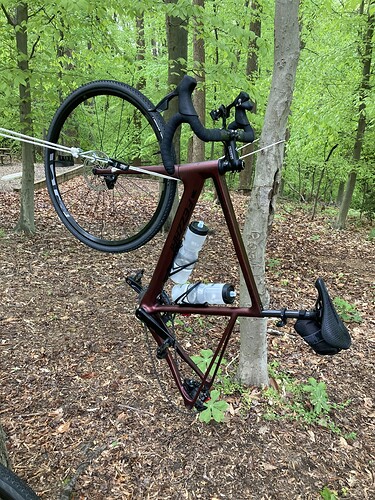

Success! Thanks for all the help answering my questions. Below was my makeshift setup. We’re camping with our homeschool group so I brought the bleed kit and a bunch of tools to work on the bike while the kids played after breakfast. Bled the rear brake (front is fine), and adjusted my cockpit setup by rotating the bars forward to make the drops more comfortable, slide the levers up to keep them in the same relative position, and angled then inward for comfort. Even got a 50-min Z1 ride in with my 13 year old to test it all out.
